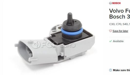

I was told by the auto parts store that I needed a fuel pressure sensor and watched many videos on how to replace one. However, when I look at my engine, I’m not sore where it’s at. I have this blue stopper thing in place of when I believe the sensor goes. I have a 2004 Volvo S80. Please see picture. Am I missing one?

The blue part is a plastic valve stem cover. Same as a tire valve cover. That's where a fuel pressure gauge is connected. The fuel pressure sensor is installed (on engines that have them) on one end of the fuel rail - So if you don't have a pressure sensor (as pictured below) mounted on either end of the fuel rail - your engine does not require one and the fuel pump runs at full speed all the time. Why do your want to replace it (a part that your car does not have)?

Hi and thank you for getting back to me. I took my car in yesterday to an auto parts store and an associate there placed a computer tester on my car and then told me I needed to order the part su13542 fuel inj. They do not have the part and could get it within a week. So, I went home and looked it up on the Internet and saw the part. It’s the exact same one that you sent me in the picture. Then, I went online and started watching videos on how to replace it so I went down to my car and I noticed that I didn’t even have one. So I started getting confused. Yesterday morning when I started the car, it started almost lunging and making a puttering popping sound. It drives fine. And the engine light came on. So I thought I’d come to this site and see what it could be and why I couldn’t find the part in my engine that the auto parts store told me I should order.
