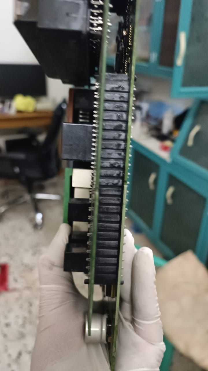

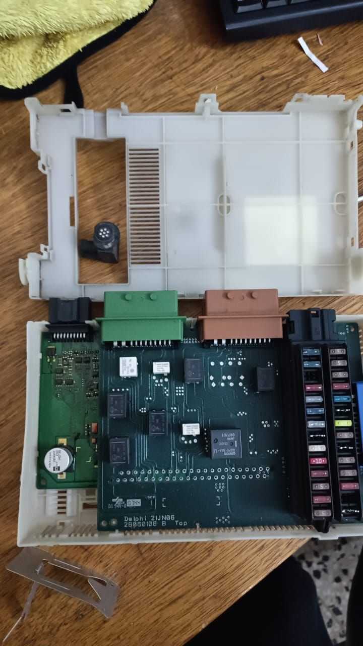

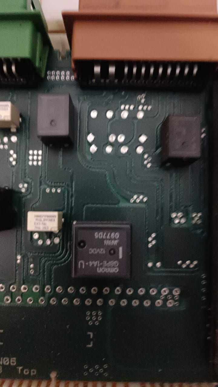

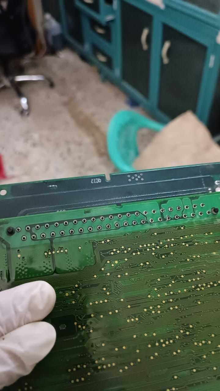

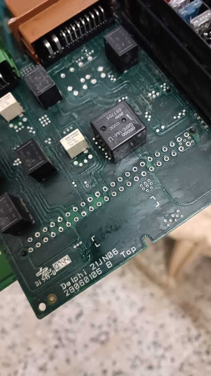

But I open the control module circuit it was dry as a bone, with no sign of corrosion
though I clean it with contact cleaner afterward installed it back, and erase error codes.
except for those 12 with climate-control error codes, more ever removed air quality sensor,
t
then the extra three codes showed up which means the air quality sensor is working.
the blower motor is working with the **** turn.
Sure water corrosion (sort circuit) is there but I think somewhere else.
