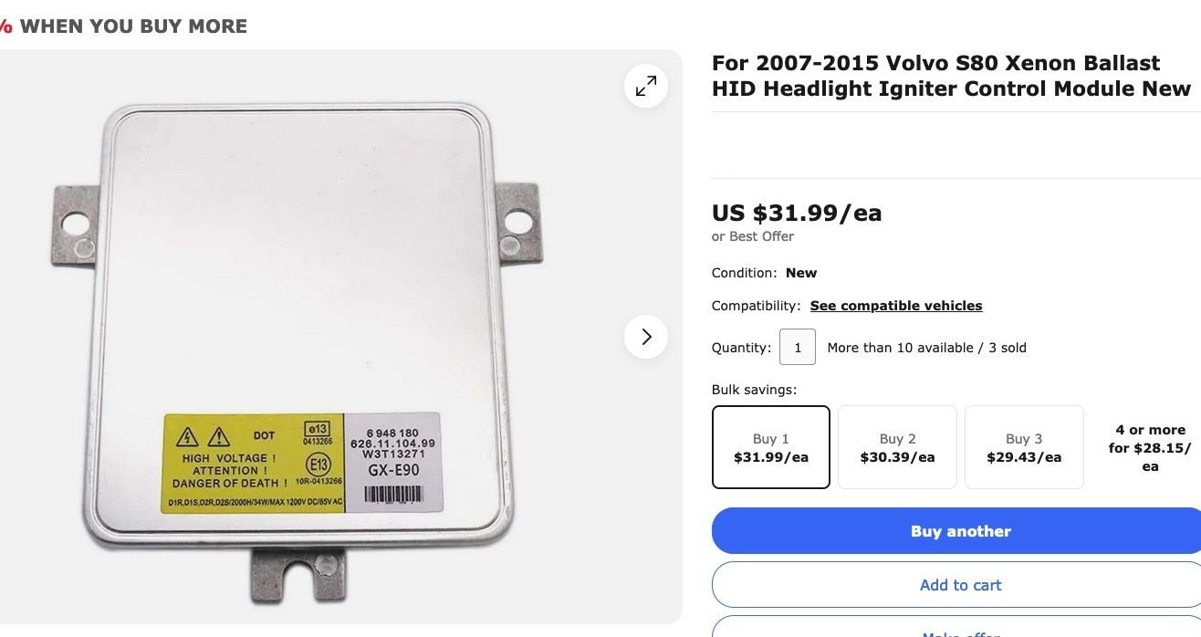

Found the solution . . . the ballast. Makes sense as the symptoms were similar to when a household florescent ballast begins to fail. I sourced mine through ebay. Takes just minutes to replace as the ballast is located on the bottom of the headlight unit.
