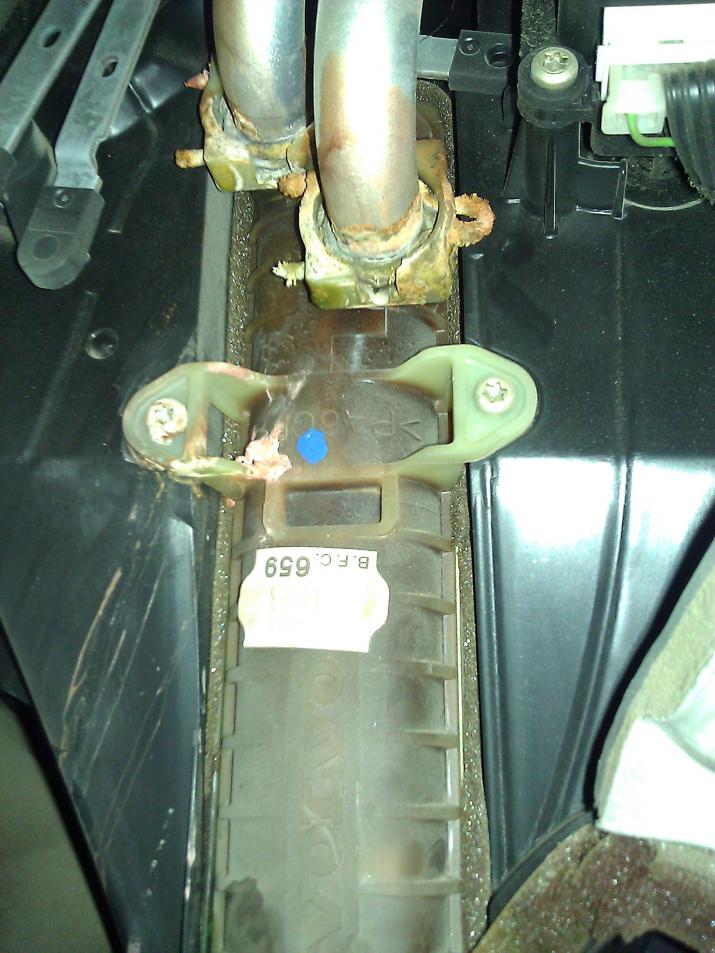

Guys, please view the pictures, can you guess where is the problem, either just to change the o-rings of the pipes or need to change the whole heat core box.

I replaced the o rings and it stopped the leak. For the cost of the heater core, I would first try the o rings,. It looks like yours was leaking for a long time.
