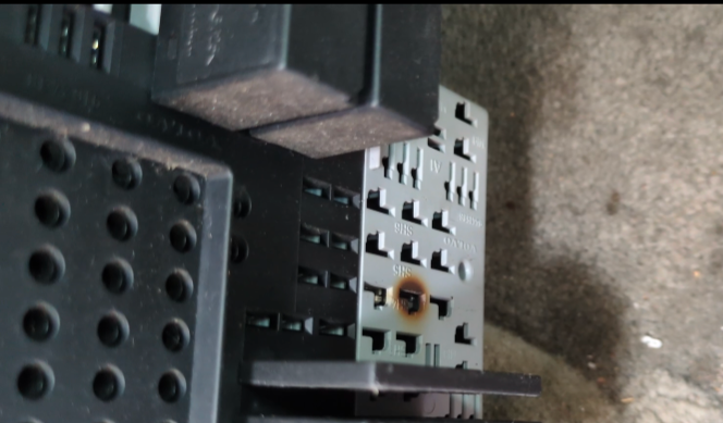

I'll have to check that out and could be a problem because I do have a cam seal that I have to replace. That was next to do on my long list. Another thing I did notice on my scan tool that it was related to a system relay output. ( Found on CEM) I went to replace it and found this...
I don't know if it's toast , but I wouldn't be surprised..
Thank you again.

Here's what I found. It was soaked in oil....

It was a blown 15 amp fuse under the hood. It controls mass airflow sensor, ECM, and Fuel Injectors......
