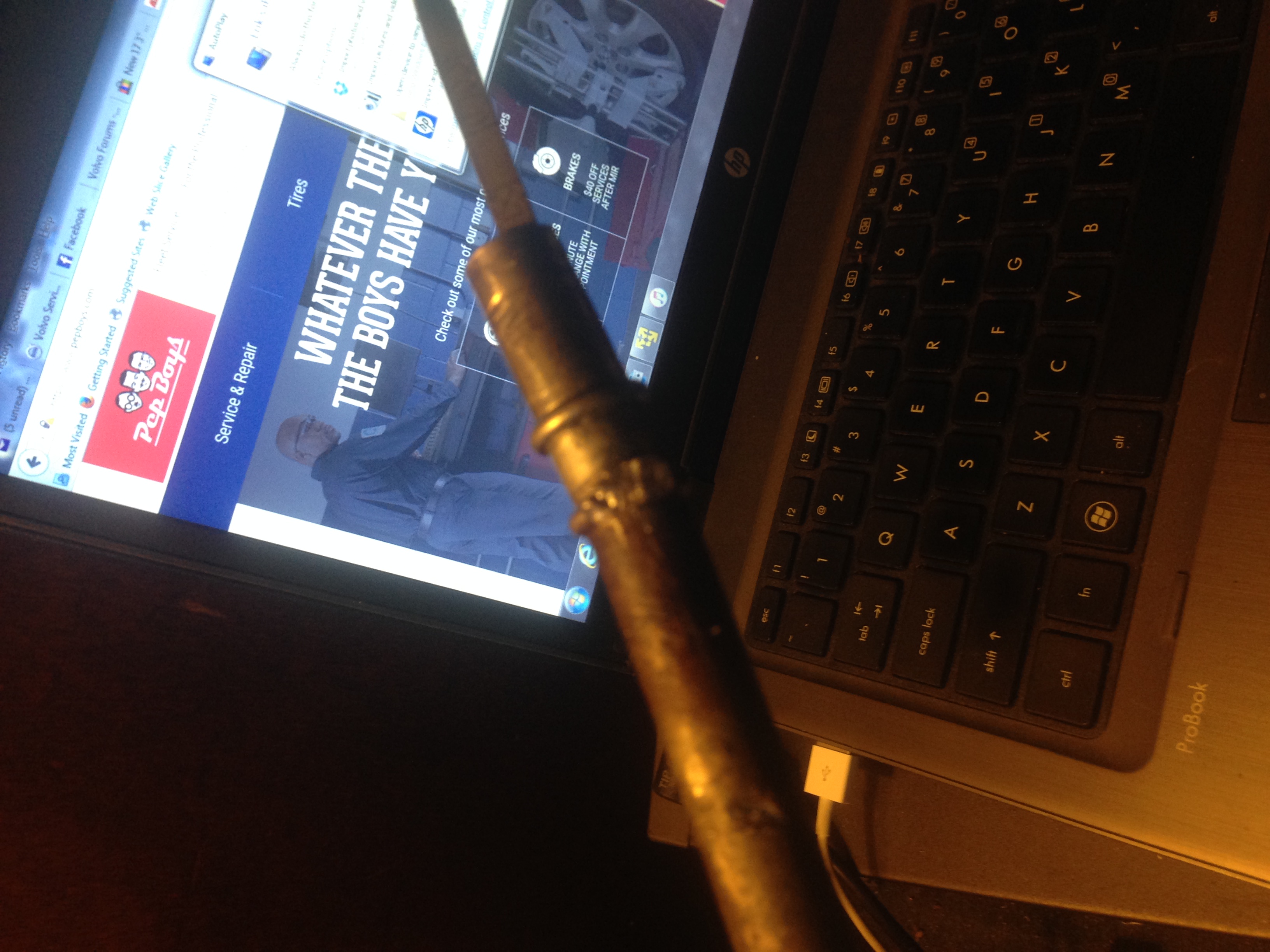

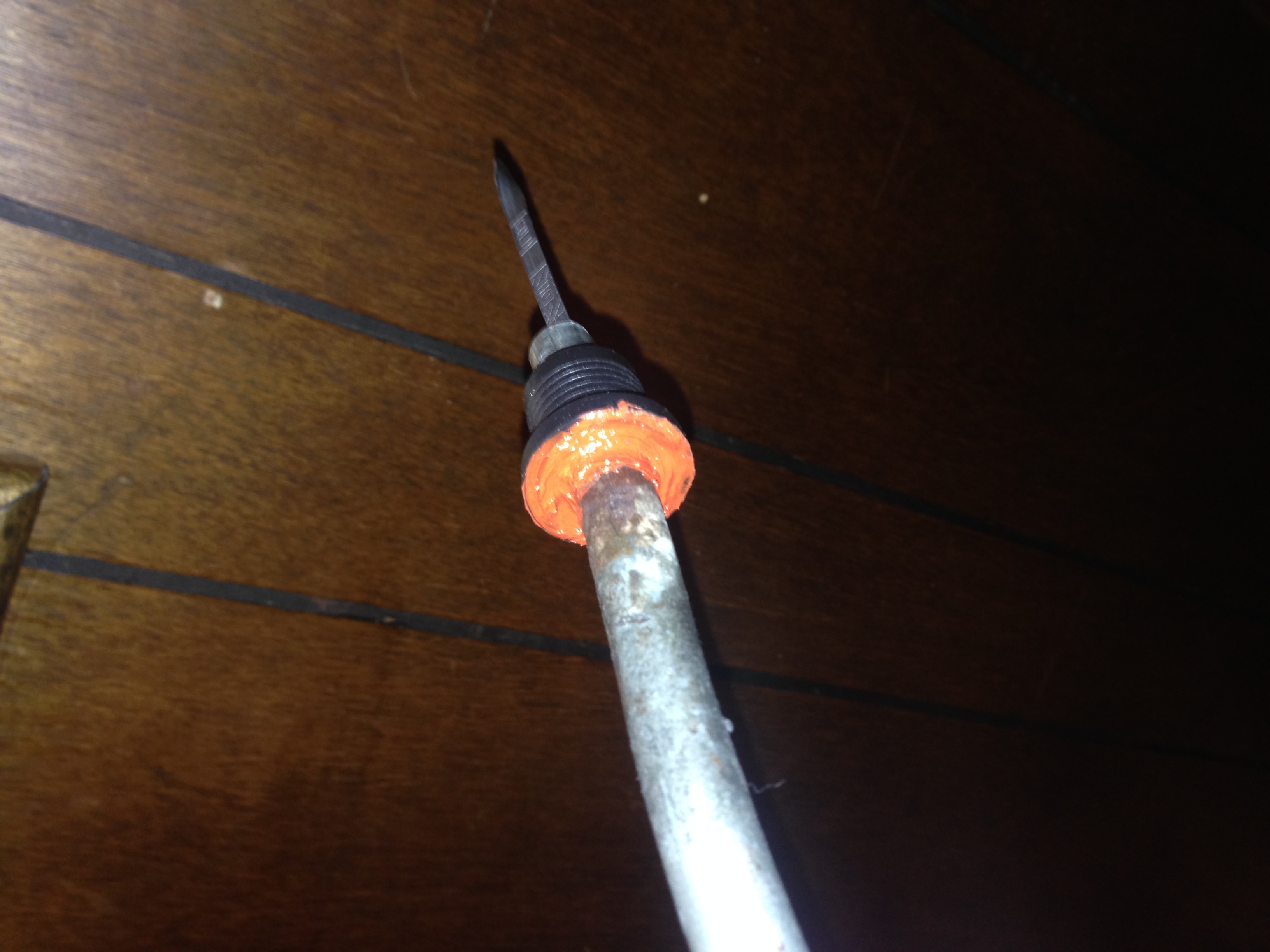

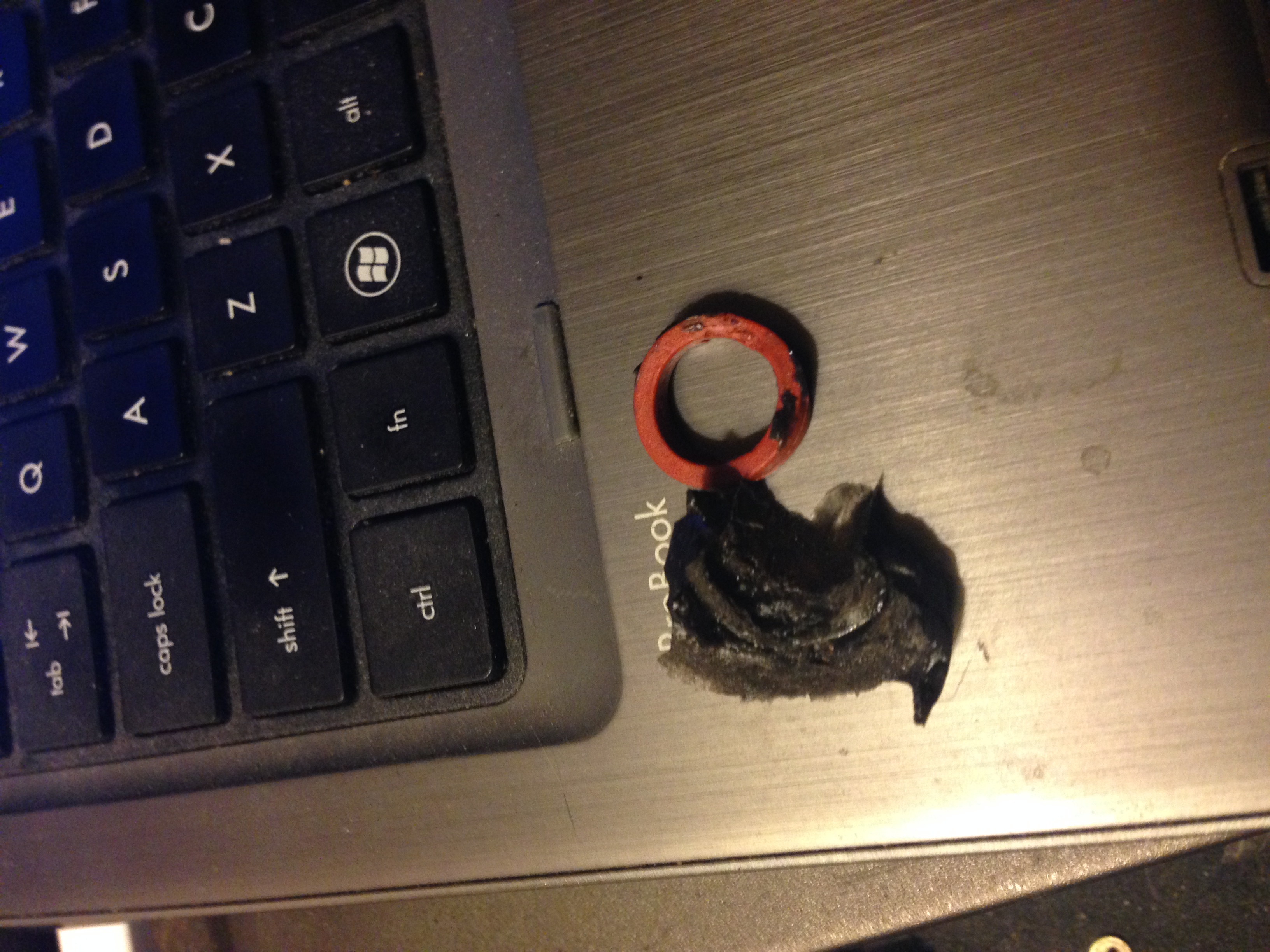

Success I got the tube out with out dropping anything but had to remove
upper support bar and upper mount
It was glued to the transmission with form a gasket
first pick is the damaged dipstick
second is what someone used
and the others are the finished repair (letting it dry over night )
wish me luck
