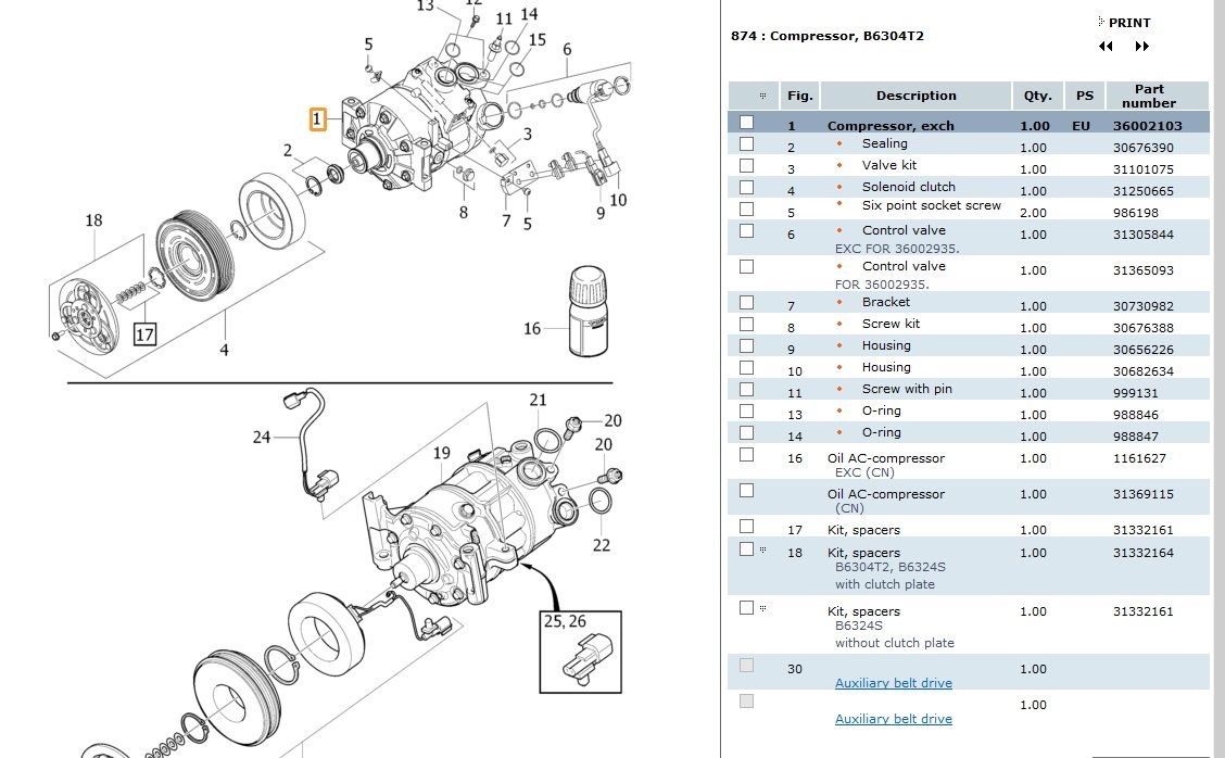

If you search eBay/Amazon/Google for "Volvo 31250520" you'll see after market compressors. Usually when you see two part numbers a model year its because there's a "parts break" by VIN ie "2009 S80 T6 From Chassis/VIN 101517". What's the last 6 digits in your VIN?

31250520 is the original part number.
What's wrong with your compressor? A couple things commonly go wrong and prevent operation/cooling. The Clutch has a dampening ring in it that comes loose and will prevent the clutch from closing and the compressor won't spin. Take outer clutch off, remove loose ring and reassemble. Or compressor spins, is full of freon (someone did an evacuate and proper recharge to make sure) but does not cool and pressures are wrong. That's usually a displacement control valve problem. Either not working or partially clogged. #6 on the diagram. A new valve makes the ac cold again. If your compressor is seized - sorry about that! There is only one part number listed - Note the compressor at the bottom of the page #19 does not have part number listed for it.

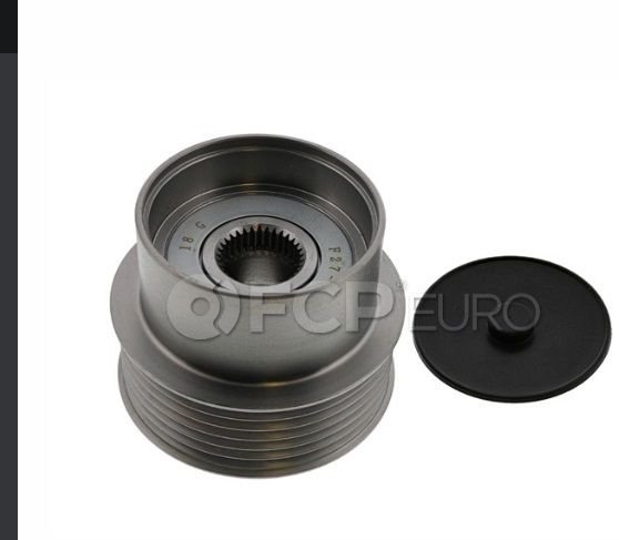

While you are there make sure the overrun pulley still works (on both the alternator and the serpentine belt) 31316803
Old Aug 4, 2022 | 08:21 PM
PeterMetaxas's Avatar
Joined: Aug 2022
Posts: 35
From: Prince Edward Island Canada
Thanks for the reminder. I did the alternator and overrun pulley late last year. While I'm doing the AC compressor and the serpentine belt I plan to do idler and tensioner pullies and the water pump. At 250K miles I'll replace anything or everything to keep the car running reliably for another few years. Doing the differential oil filter and oil as well while it's laid up.
