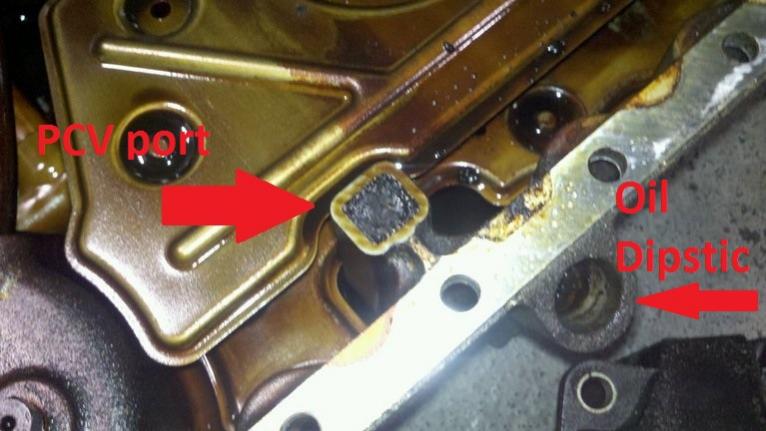

I didn't ask about crankcase pressure. Difflock54 you're talking about making sure the passages in the oil pan the PCV uses are open when you do a PCV replacement, right ??
Attached Thumbnails Looking for opinions on whether I should sell or fix?-pcv-drain-holes.jpg   Looking for opinions on whether I should sell or fix?-pcv-oil-pan-passage-blocked1.jpg   Looking for opinions on whether I should sell or fix?-pcv-passage-oil-pan-circled.jpg
Yes, I have read of cases of people doing a PCV service and either not clearing, or inadequately clearing the ports,especially the ones in the block.
It can contribute to an engines clogging problems when the above occurs although probably more likely to blow out oil seals.

In reply to the questions about the PCV ports, thats a good idea, but I actually have cleaned those out. The big one on the side of the block was completely shut when I did the PCV job, but it and all the others were totally clear before I started putting hoses back on. Also the ones in the oil pan/lower end of the engine weren't completely blocked when I pulled it off, but I did clean anything I found while I had the pan off. That reminds me, I also go the o-rings replaced a while back when the whole problem began, good thought though.
