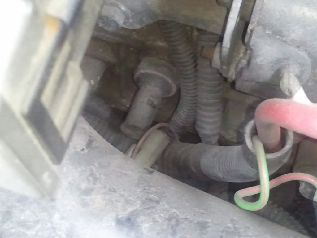

When I was replacing the fuses, I saw this...
Anyone know where this goes to? does it plug into the cylinder that is right in front of this? Any help will be great! Is there anything else that I need to check that is as easy as plugging it in?
Old Dec 15, 2011 | 12:37 PM
elmo_allen's Avatar
Joined: Aug 2008
Posts: 197
From: Indianapolis, IN
Well I plugged in this piece and I got a "no oil pressure, stop engine." I have never gotten this message before. Before we got this message I had my mom push the accelerator to see if I could hear if anything went wrong. When I went to the rear of the car it smelled like the car was burning oil. This is a known issue to me because I have to put oil in it about every moth or two. I checked the oil, and it is two XX from the top of the stick. Could this be related to what I am dealing with or is this another issue on top of everything else?
