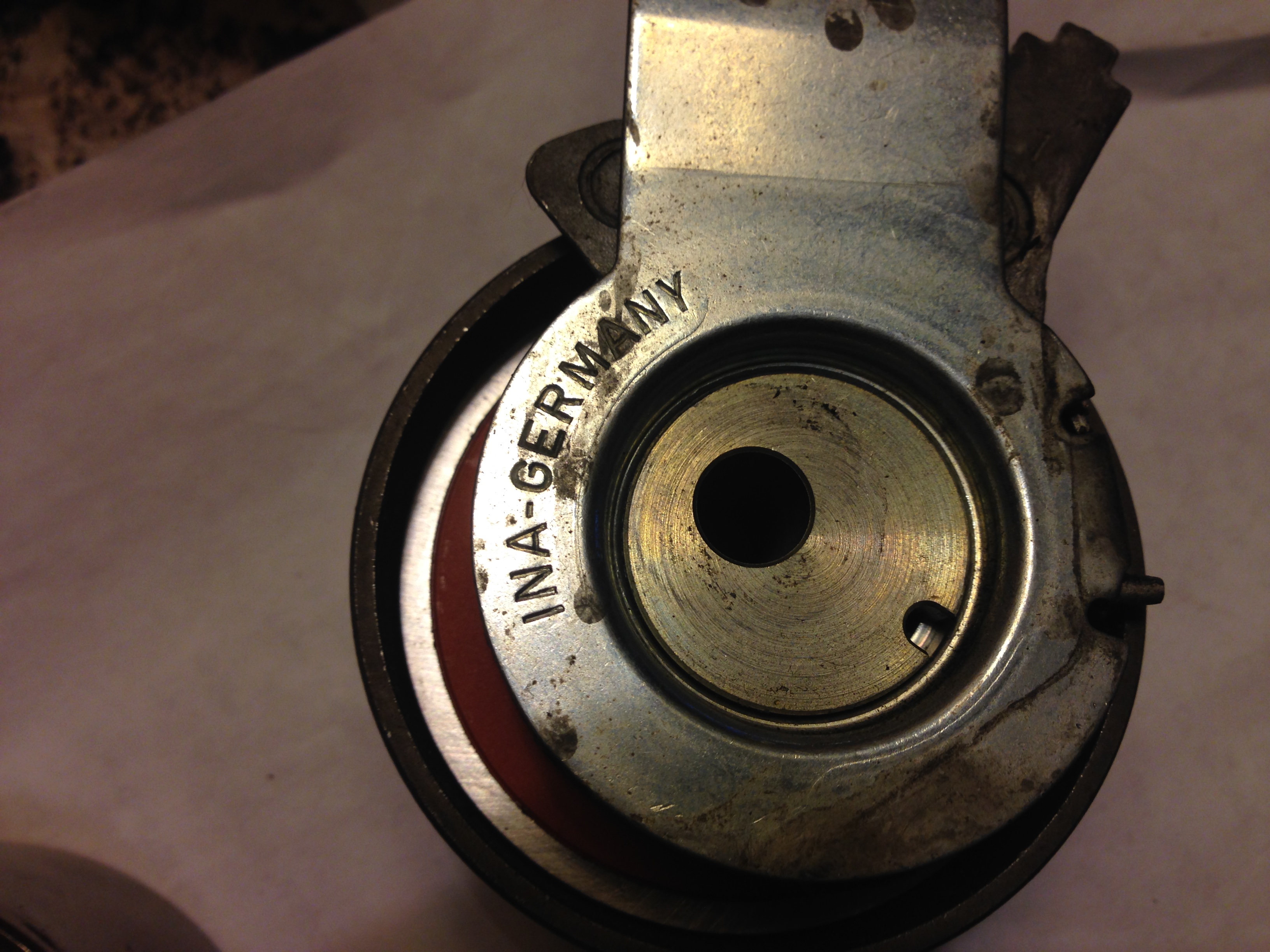

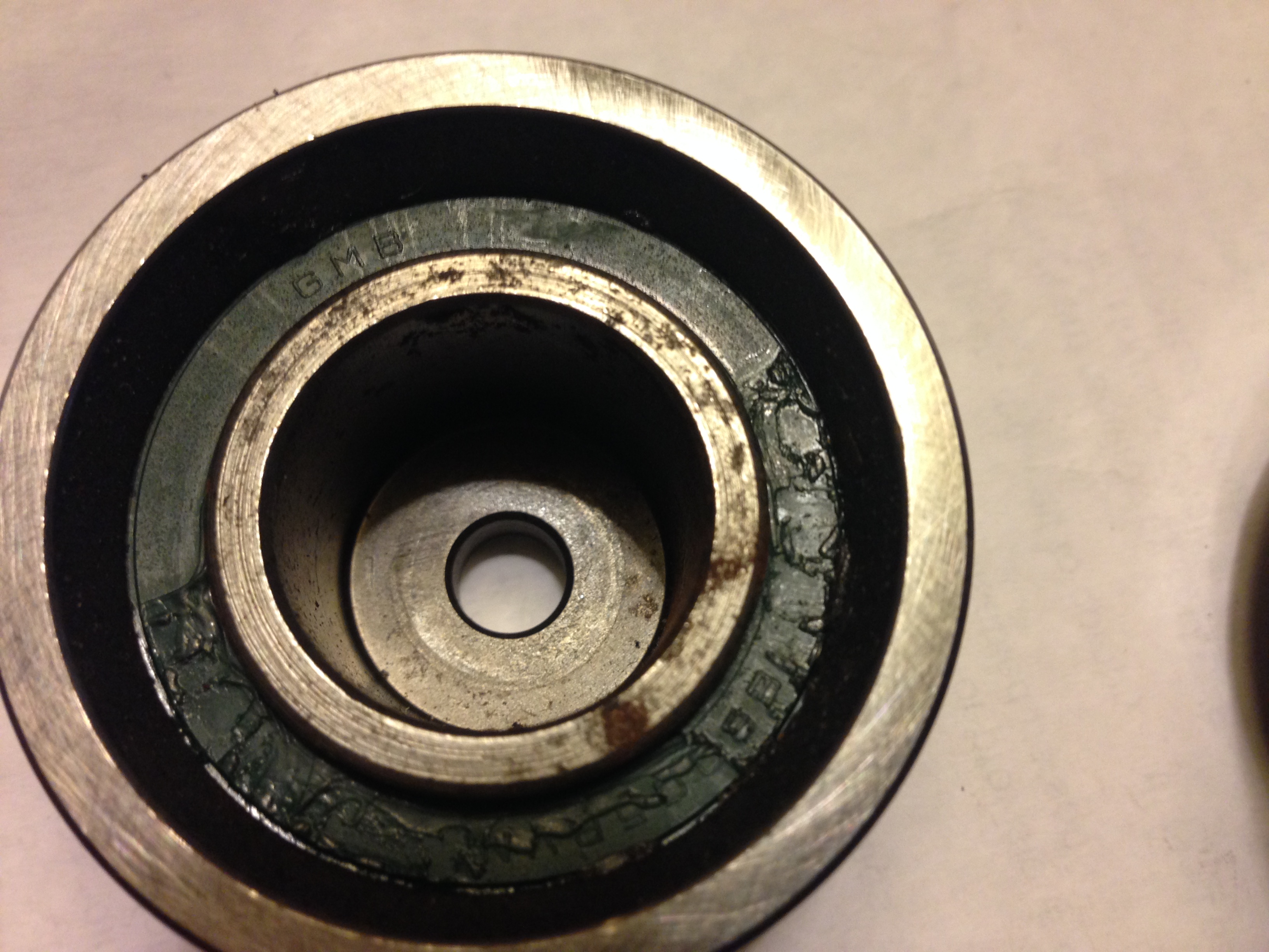

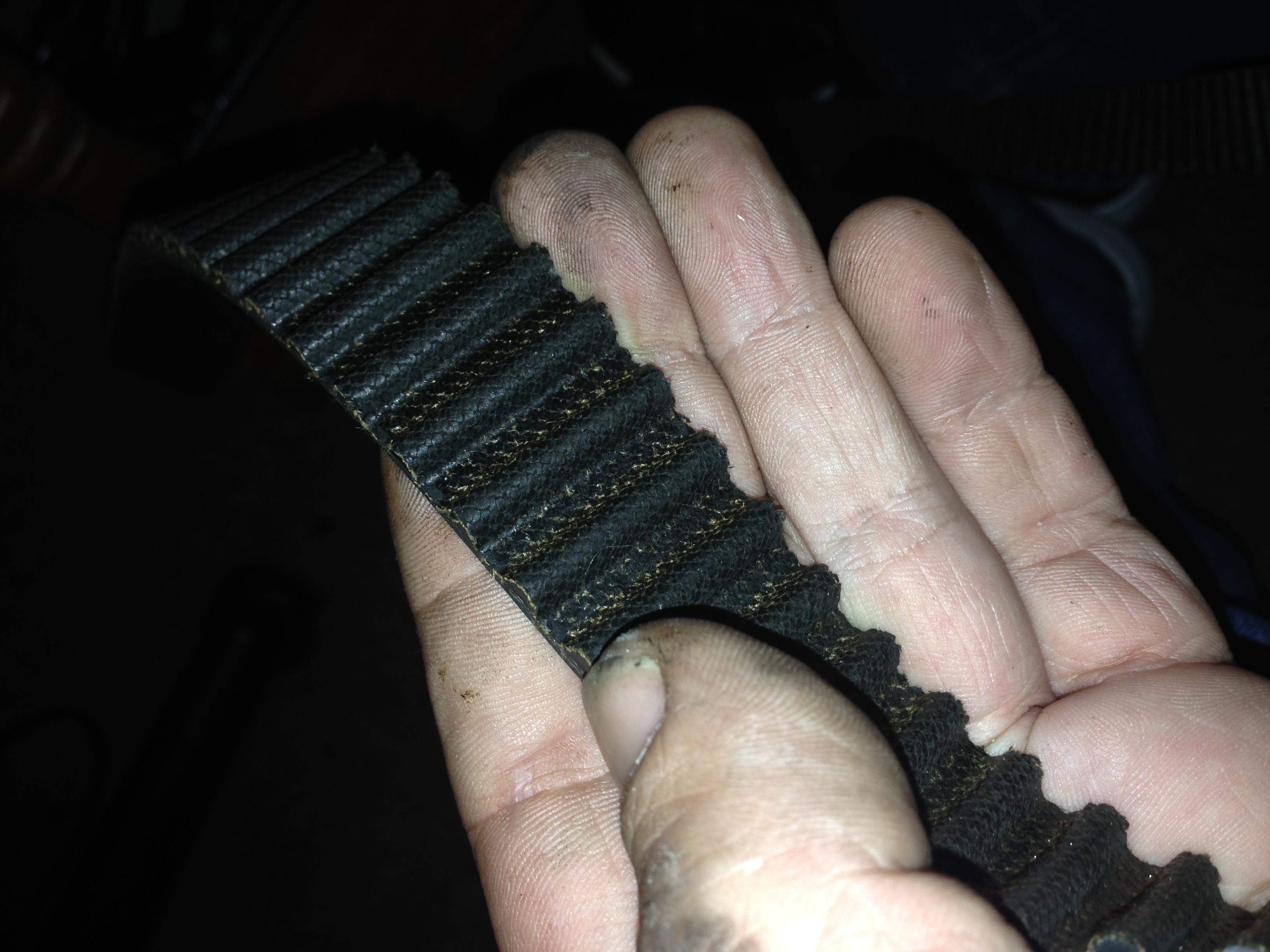

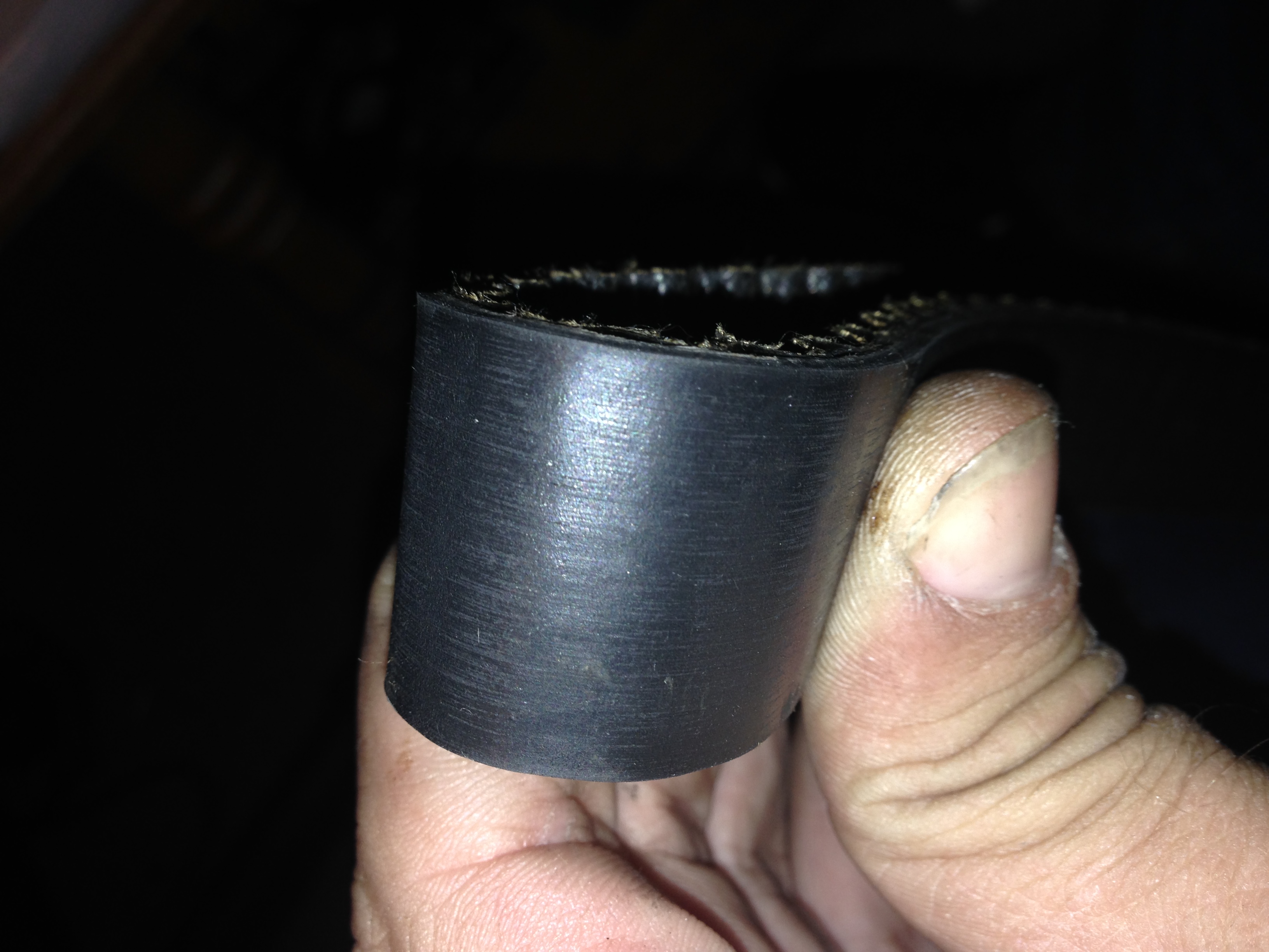

I bought my S80 back in August (first time Volvo owner)
with 207,000 miles on it ,
It has the 2.9 liter twin turbo...
I decided to go ahead and replace the timing belt ,belt tensioner ,water pump,
and idler pulley ...
My dad said I coul've let it go for awhile but figured 1. he's old school
when most engines used timing chains.. 2 it's better to be safe than sorry
and end up with a unpleasant surprise .....
here are the pictures I took...
if I'm not mistaken the idler looks worn and older than the tensioner

I think the interval is 110,000 miles for belt change. It was probably done once at about 110,000. It would have been fine for a while, but was getting close enough to another 110,000 miles that doing it was not a bad idea. A lot of manufacturers are going back to chains so your Dad will be new school.

105,000 or 10 years per Volvo
Service Manager Bulletin 21-044
Engine Code/MY
Engine Version
Replacement Mileage
Vehicle and Regulatory Description Notes
91
B6294T
105,000 miles / 10 years w tensioner & idler pulley
