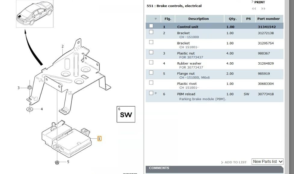

1. There's no warranty on their work? If the new CEM/BCM did not fix it - have them put your old one back in, and refund your money. Unless they were instructed to replace a part that did not fix it - you should not be responsible for their mistake. Perhaps you should pay for some (incorrect) diagnostic time - but not for a new control unit that did not fix it.
2.
3. Most modules, if they are "coded" to the VIN - can only be coded when they are new. Usually Vida can't "recode" a used part. But it's possible a used one might work, I have not tried. Have you verified Volvo can do this for you? And a software download is usually about an hours labor plus the less than $100 software charge. How did you get a $750 price? I'd bet the $750 price is for a NEW PBM installed and programmed to your car. ( since that part number is about $400)

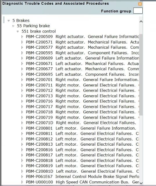

Here's some of the PBM codes. What codes are stored in your car? Or are you just replacing parts hoping to fix something?

Update 3/16/23: I found the rear brake module, but did not swap it out. When I looked at the part number that was originally in the car, it was a different product code. I called the dealership and they said that these have been superseded several times and the one they provided was the latest (no wonder I had trouble finding one used). When I pressed as to whether it would work, they had no clue. They said that some of these parts are hard coded to the car (Like the central computer that I replaced for $2K). So I pressed some more and they relented and said they would try it and not charge me if it did not work. So I had nothing to lose. They put it in and it worked after reprogramming!!!. So these rear brake modules are not hard coded to the car at the factory!
I paid $54 for the used rear brake module and $420 for software and reprogramming. I got away for under $500 (not including the original $2k I spent with them. They quoted me $750 for a new module and installation/programming was $400. So if you have the same issue, buy a used one and save a lot of money. And don't do what I agreed to do and replace the entire computer in the car. That was a waste.
