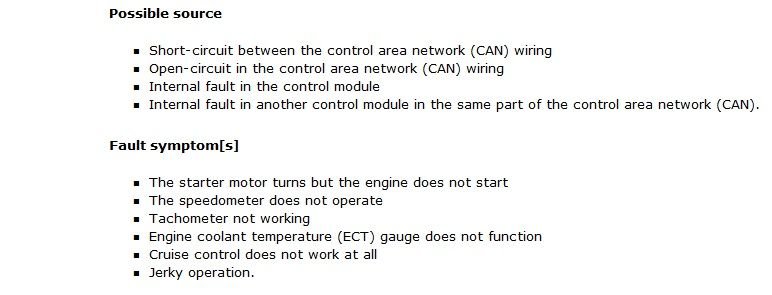

I don't see the brake control unit listed as a possible source for any of those codes. What are you basing your diagnosis on? You might could talk with xemodex - they might talk you out of replacing the wrong part. If those are codes from VIDA - click on the codes to get diagnostic information.
1. cem - e000
2. bcm 0148
3. eps 0080
