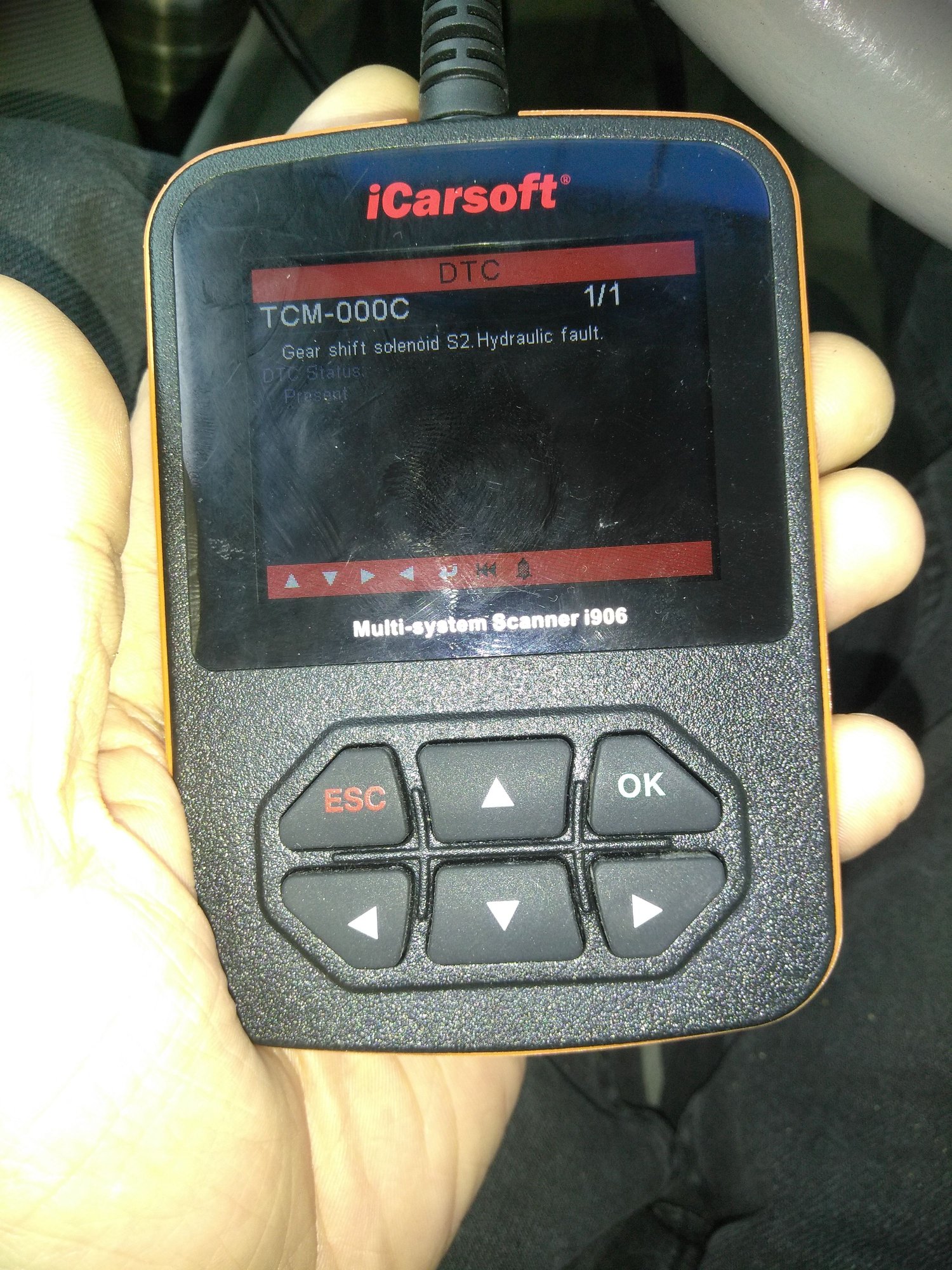

Well I guess you guys have been waiting for me to post this. After 6 months of no transmission error codes . It finally happened today. 3rd gear is hardly working. Time for me to find a used transmission .

I would get that code clear it and it would work fine again.

I did , but it came back a couple times, cleared again. Had transmission codes back in August (cleared them ) and was fine till today. So should I replace the the transmission or try replacing the solenoid? Thank you again.

It just happens more and more, until finally no go. Surprisingly it`s not the solenoid but burnt clutch packs make that code appear, apparently they cause the solenoid to not operate correctly, at least it did in mine. Your transmission is done. I had mine rebuilt and the solenoids were all fine. You really want to rebuild your unit as finding one that matches perfectly to your ECU is difficult at best. Besides you really have no idea what you are getting. Shop around, I had quotes from 2K to 4.5k for a rebuild. I went with an independent shop for 2k and a 2 year warranty. Works perfectly. I use the same scan tool BTW. It`s a great piece!

This tool has been great, probably the best $100 that I spent. I figured the clutch pack was going bad just from the research I did. Looking like I have to start saving my money.

After 7 months of trying to figure out if my car needs a new transmission. It's hard to explain all
Of the the symptoms accurately . But to basically
sum it up , it felt like it was losing hydraulic pressure.
​​​​ After doing some research on this transmission,
and talking to a transmission expert . Turns out
that it's the pressure control solenoid . It regulates the pressure for the entire system . If ignored it can cause complete clutch pack failure. It will be getting replaced with in the next couple of weeks. I've taken
measures to keep it from over heating. I was quoted 5 hours at $70 an hour , I figure it's worth it. Better than spending $2,000 for a complete rebuild .
