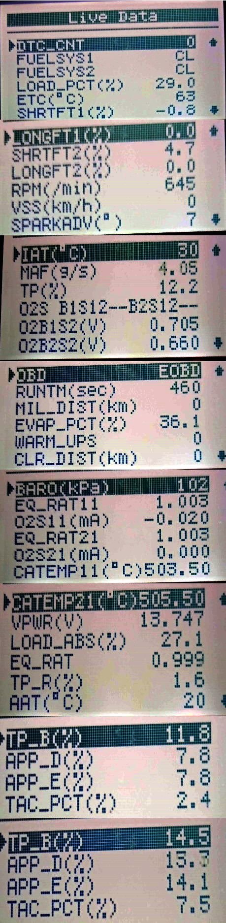

Old Sep 17, 2021 | 05:58 AM
  #20
Volvotastic's Avatar
Joined: Feb 2014
Posts: 24
From: Somewhere on the river trent - 170 miles long by the way!
Question MAF check next? Cold start issues
Had the CEM rebuilt and now I can start after some seconds of cranking. I have read the Live Data and the readings shown below are once the engine has warmed up but what I noticed was the Sort Term Fuel Trim readings (SHRTFT1 and SHRTFT2) were -55% when cranking initially. I have checked for air leaks with brake cleaner and gas with no sudden change in the engine tick over. I have cleaned the MAF but still wonder if the MAF is the problem. Any ideas how to check the MAF? All spark plugs show normal combustion so I don't think the injectors are the problem. I have changed 3 of the ignition coil packs which did help it run more smoothly.
UPDATE : I have used a better OBD reader and checked misfire on all 6 cylinders (all passed!) and the O2 Sensors (all passed),
Cheers Folks.
These are readings when the engine is HOT
