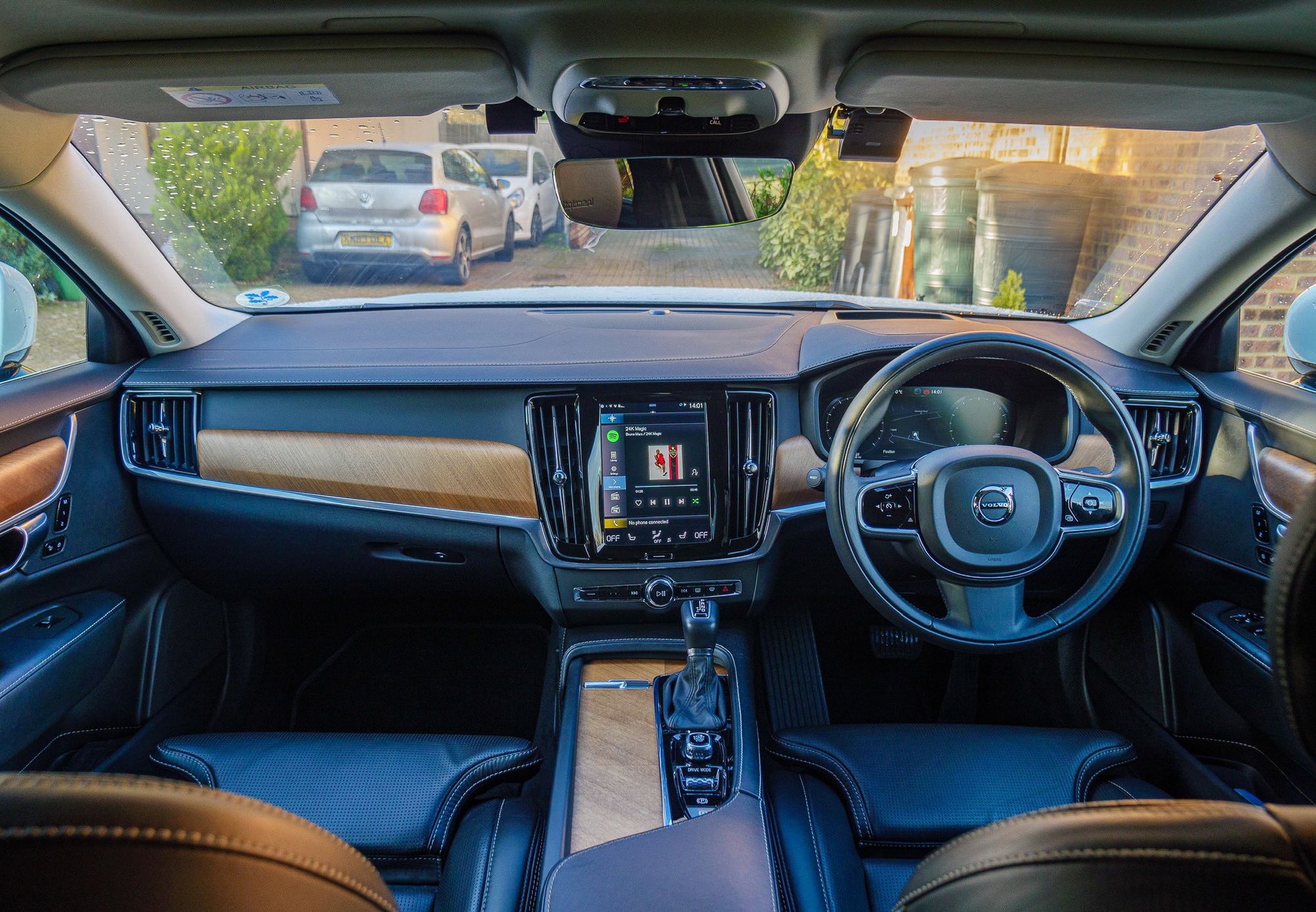

I did quite a bit of research on this. Not to effect sensors or Volvo cameras and the best dash cam as I was a professional photographer. Sensors for dash cams are important as most are years behind.
I settled on Thinkware U1000 plus radar unit and rear camera polarizer lenses and obdII power cable.
works a charm and and thinkware U1000 has a sensor much newer than other top brands. Yea it’s 500 for the complete kit but hey. It’s an s90 inscription plus. So I want the best protection possible and have it now.
Radar unit on left top and u1000 thinkware on right top. All wires run to the right and down. Rear is center top and cable run down the right and extra is in dash right cover. Works a charm
