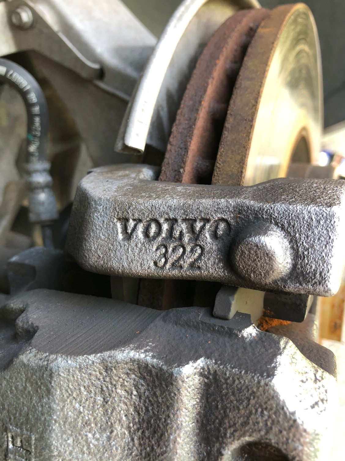

Old Jul 26, 2020 | 10:15 PM
Andrew DeLessio's Avatar
For anyone looking for this info, the size is stamped right on the brake caliper. If you have narrow spokes/large openings on the wheel, you can see it using a small mirror, without taking the wheel off.

Old Jul 27, 2020 | 12:25 PM
Likes: 541
wheel size doesn't project to the rotor size. good tip on looking for the stamping on the caliper carrier.
Old Jul 27, 2020 | 01:27 PM
yes, but if you have a 2018 T5 with the 19” wheel option, it’s pretty safe to say they are 322MM like mine.
