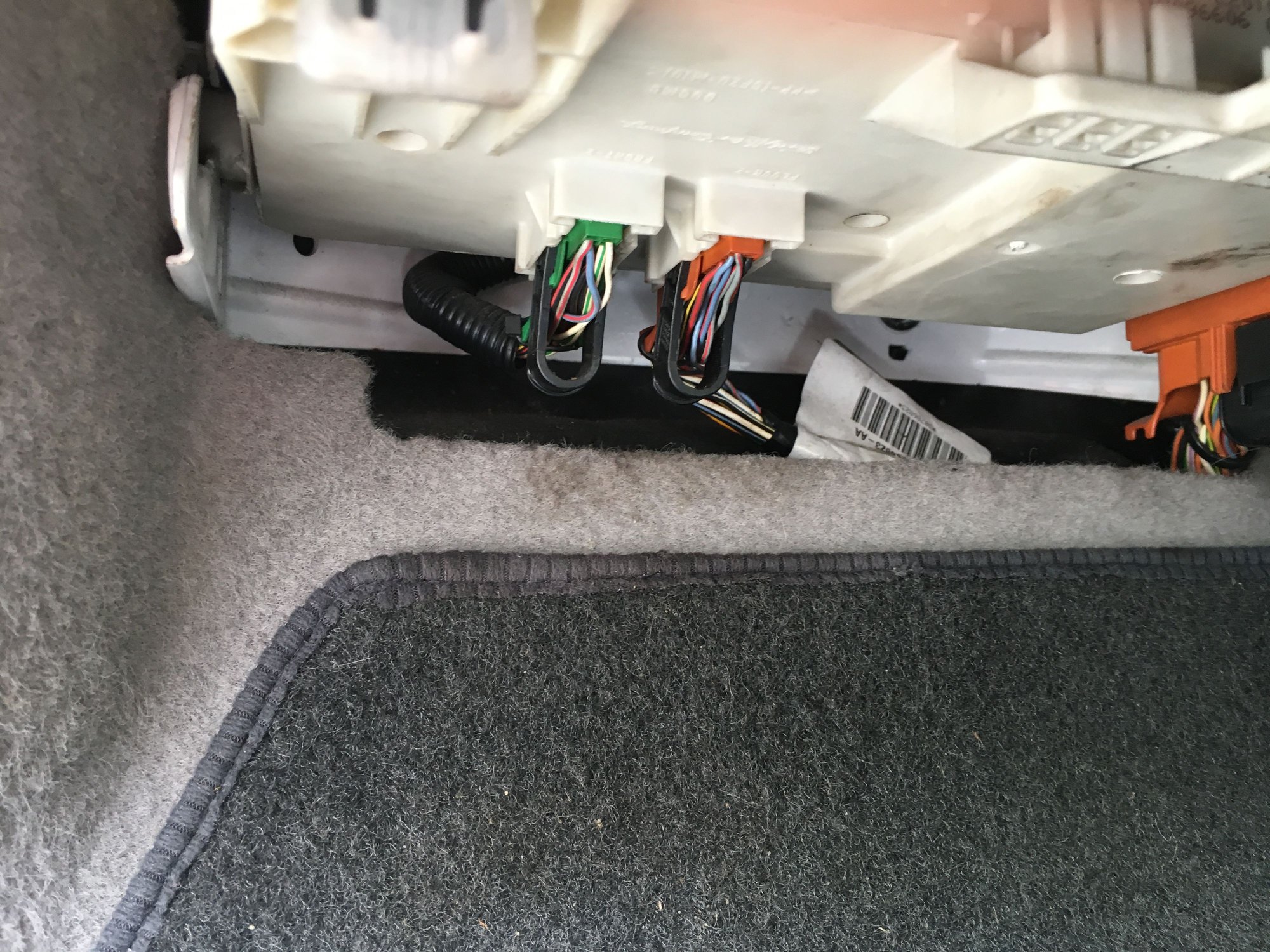

Originally Posted by Pilgrim999
Suddenly one day, the windshield washer started going, and would not stop. I eventually disconnected the washer motor, but the wipers still keep running; the only way I've found to stop them is by removing the 25amp fuse. The washer motor and the wiper motor appear to be functioning well. Where should I look, what should I do?
check under the glove box, there is located the CEM, I bet you the orange cable is disconnected
