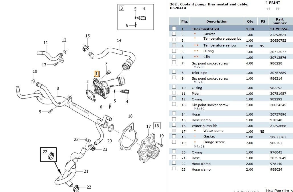

Old Oct 8, 2021 | 04:51 PM
Sory the only t4 listed is a 5 cylinder - for your b4164t 4 cylinder - here's some pics, remove the alternator first to get to it then a valve (#10), three hoses, and 4 bolts according to VIDA.

Default Thank you!
Ive managed to get the alternator off, hopefully tongith will get the thermostat off, any chance you have a nice diagram for putting the alternator back on, I couldn't see the tension thing for the belt anywhere

Old Oct 14, 2021 | 01:53 PM
Old Oct 14, 2021 | 04:13 PM
Derick132435's Avatar
Joined: Oct 2021
Awesome thank you so much! You are a life saver. Where do you get all these amazing diagrams?
