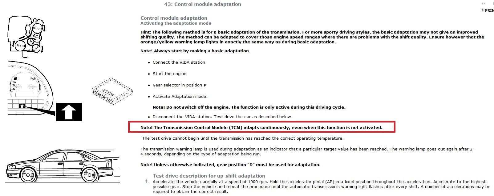

Software does not change after you drive. The transmission "adaptation" does. When you replace a transmission "adaptation" is required to teach the control module how it should shift the new trans (in as quick a manner as possible). And as you normally drive the Trans control unit adapts constantly to give you the best shift quality. If you still have poor shifting, it's because there is a mechanical problem. So new software (costing a few hundred dollars using a VIDA subscription) will not fix anything. Poor shifting could be fluid flow is not correct due to wrong or degraded fluid. That can change with fluid temperature. Could be fluid flow due to sticking solenoids (common) or a worn valve body. That can change due to transmission temp. Worn components = larger clearances when hot = poor fluid control = bad shifts. Could be more internal with the transmission - clutch packs can stick. Worst example case is car is in 2nd, solenoid says shift to 3rd so solenoid a releases 2nd gear clutch and solenoid b applies 3rd gear clutch - except the 2nd gear clutch is slow to release (maybe due to fluid not slippery enough when hot) - then the trans is momentarily in 2 gears at once and tears itself apart a little bit every time that happens.
Here's the beginning of the adaptation sequence. Takes about 45 minutes and can help with shifting - but not if there is an underlying mechanical problem, the shift problem will just stay or come back - because the best shift possible is already happening.

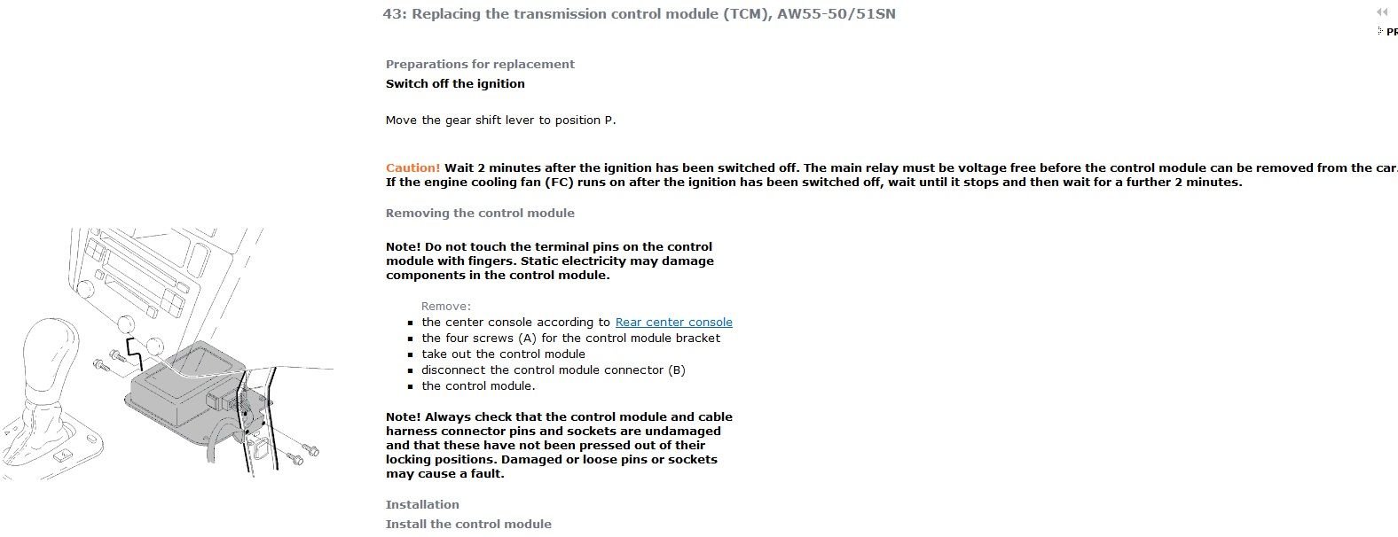

Also below is where your TCM is - if you are curious and want to check connections.
