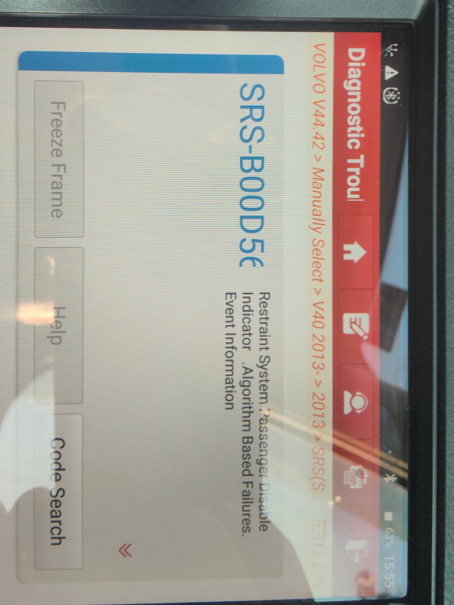

​​​randomly got this code for srs airbag service urgent about 2 weeks after this alternator went cleared all codes but can't get this one to go away anyone point me in the right direction

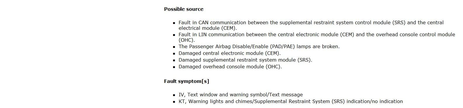

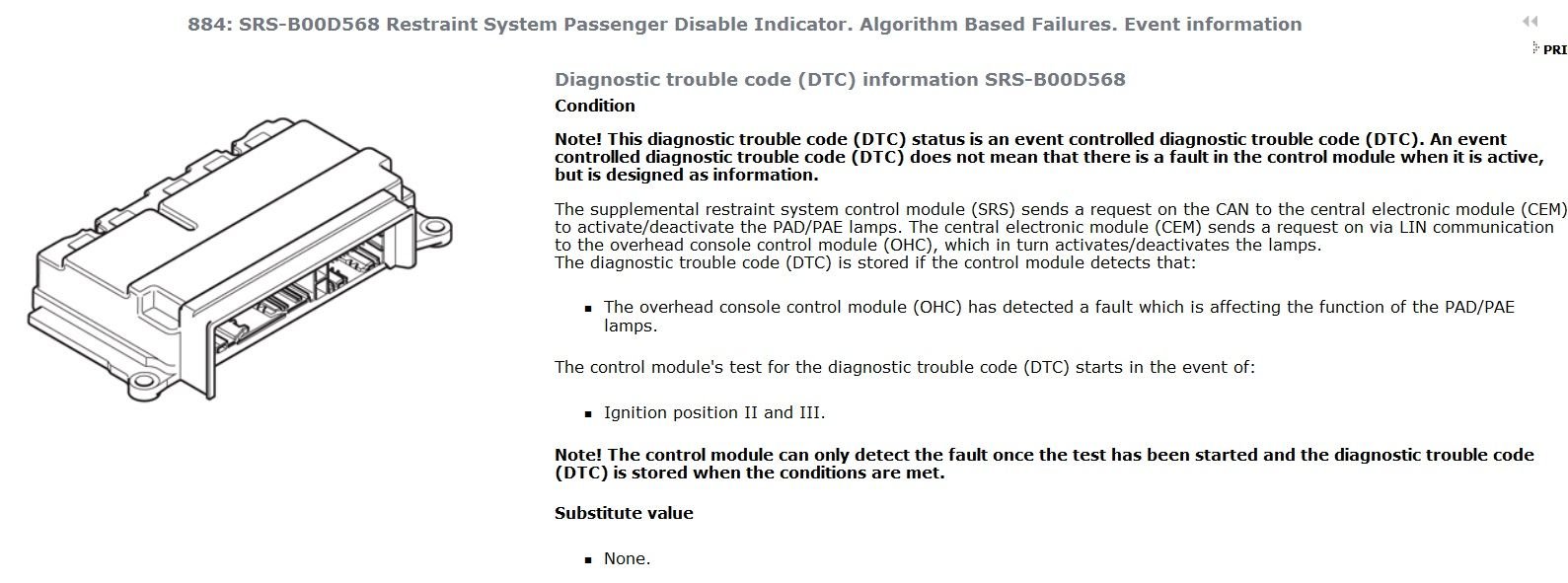

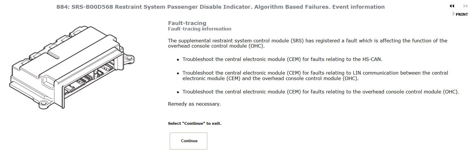

Old Mar 3, 2025 | 07:51 AM
If you car is a 2013-15 v40 this is what Volvo has to say about that code
