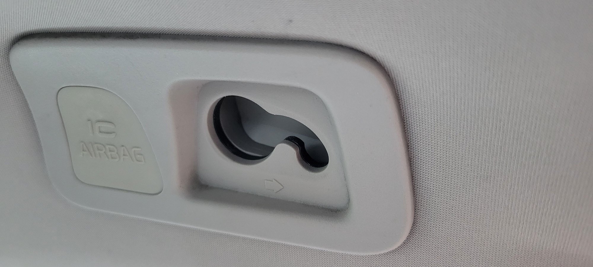

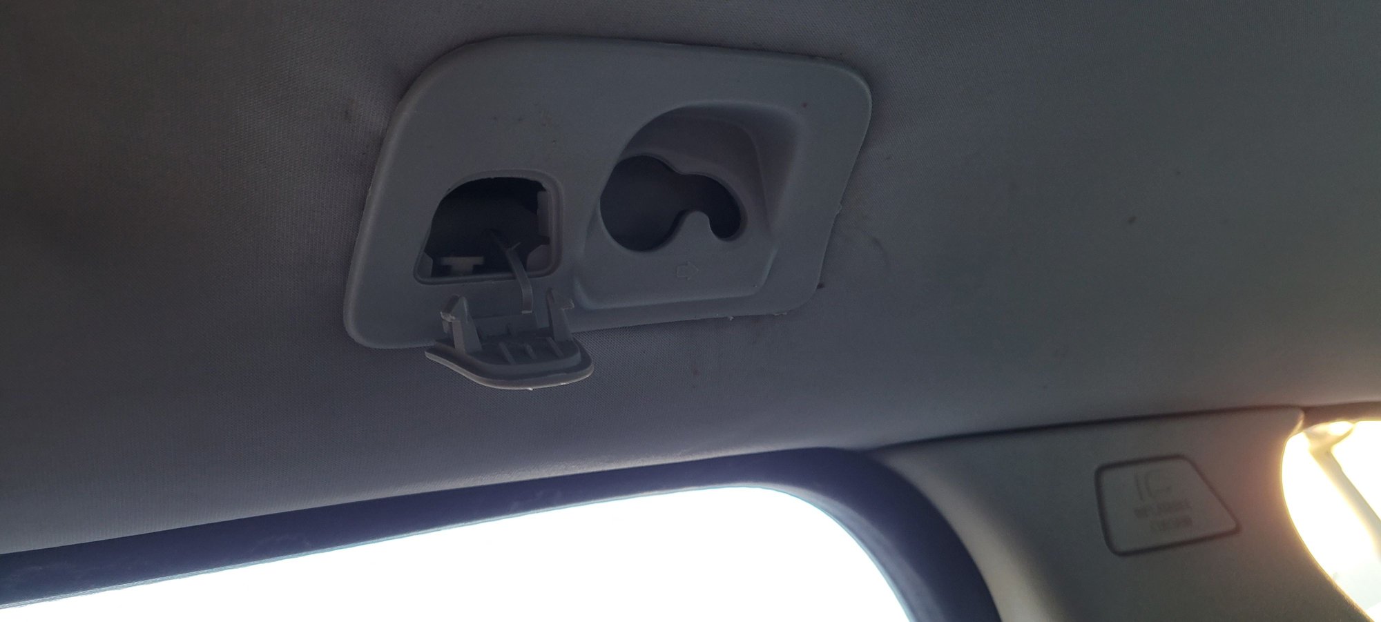

I am trying to remove the sagging headliner from my V50. Everything up top is removed so far except these 2 guys on each side in the rear. I was going at them until I saw the air bag inside... Any ideas on how to safely remove them?

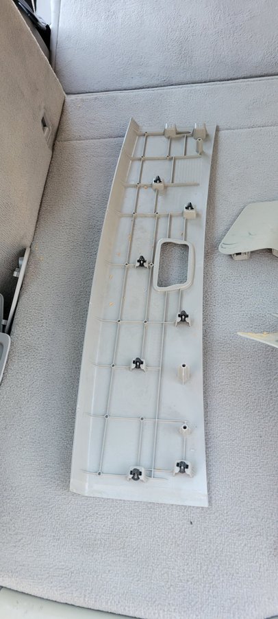

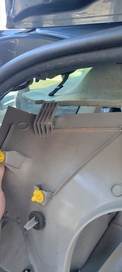

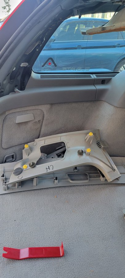

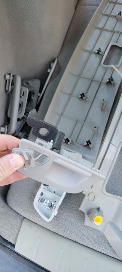

After some trying finally managed to get the headliner out. The process is the same for S40 in the front. When it comes to the rear though it differs. These two plastic panels have airbags behind them be careful and disconnect battery and the juice drain. The covers on the panels can be popped off with a finger nail. The more rear one labeled IC airbag was more stuck so I lifted the outer edge of the whole panel to push the smaller cover out. Once the covers are out use a 13 mm socket to remove the bolt and the panels will be loose. They are still attached to a plastic bracket via tabs that sits between the headliner and roof. The headliner is only attached at this point by the rear covers. First loosen the panel by pulling or prying that is AC for the back. Next loosen the more rear panel so it can wiggle the headliner out. The center most rear panel needs to come fully out and takes some will power to remove. Some pics of the panels are included
corner panel with tab holding headliner, need to loosen rear ac panel and lower corner panel to remove this guy
corner panel needs to removed
Panel with 13 mm bolt that I originally posted about, 4 in total, 2 rear ones cover needs to be pushed from inside
Center rear panel with light, does not come off easy
