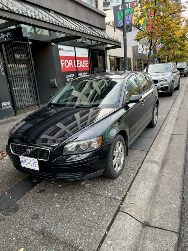

I got a great deal on a 2.4i v50 auto trans and I'm fixing a few issues so my daughter can use it as a first car. It has done 234,000 km and has been used very regularly by a family so filthy but is straight and solid. I'm replaing control arms front and rear and tie rods but other than that it's good...except maybe the auto trans.
The seller says it clunked on shifts - especially on the downshift when coasting to a stop. I didn't really notice it when i tested it or drove it home, and it went up on my hoist immediately when i got it home, so I can't say if it's a real problem, but reading up on the complaint it sounds like it's a reasonably common thing.

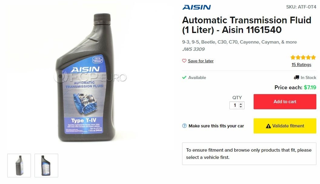

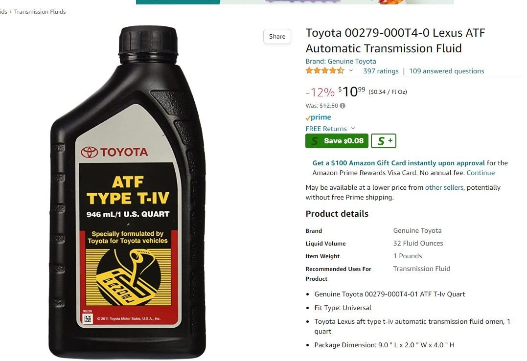

3. A drain and fill is always a good first step - be sure to use ONLY the correct fluid. That trans was used by many other car makers - and the same as Volvo fluid is available at more reasonable prices sometimes. Look for ATF type t-iv or Jws2009.

I also bought a V50 2.4i with clunky downshifts (for chump change as a result). New fluid did help, and is no doubt a good thing to do, regardless - though in my case it didn't clear up the issue. The fluid I used in my two (previous) Volvos was the Mobile 3309 (synthetic). I suppose I'd trust Aisin fluid (since they made the transmission), as long as it's JWS 3309 rated, of course. Figure doing a drain-and-fill is a good idea, even if you DO end up doing other work (requiring another drain), since two sequential drain-and-fills will leave you with much cleaner fluid than only one.

1) I drained 4.1 litres of fluid out of the trans and refilled with Mobil1 ATF 3309.
a) Took me a while to figure out that the most efficient way to fill it back was through the dipstick. There's no other easy way. I put a length of fuel line I had into the filler neck (nice tight fit) and ran that up to waist level. I then put a funnel in the other end and that worked a treat. The dipstick is hidden under the airbox toward the right side of centre line for those of you wondering in the future.
b) I selected Mobil1 3309 after asking my parts counter guy if he had any JWS spec fluid because that was the only spec given in the manual (and was referenced above). He asked what car it was for and his computer came up with the 3309. I looked on the back of the bottle and it referenced Toyota Type T-IV and that was good enough for me. Nowhere on the bottle does it mention JWS.

Great car from the short bit of driving I've done. My daughter is driving it though, so I don't even get to enjoy it.
