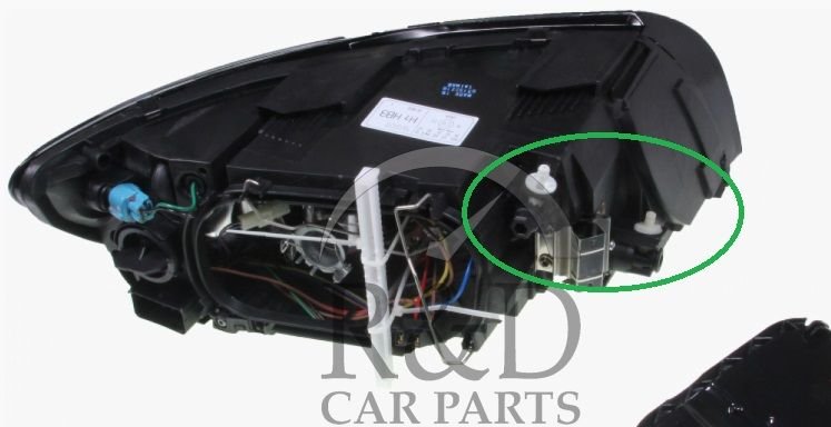

Originally Posted by Romed
Vertical alignment of the bulbs is easily adjustable, lateral is not.
Are your left/right , up/down adjustments not the ones circled in the picture below?
Old Nov 5, 2022 | 02:59 PM
Romed's Avatar
Joined: Nov 2022
Posts: 6
From: Denmark
haven't seen those. The Haynes manual says there are no such adjustments for my model and any adjustments need to be done by Volvo. Also, the high beam is adjusted nicely and gives a lot of light even with standard bulbs. It looks to me that these adjustment screws would move the reflectors or at least all the bulbs rather than the low beam bulbs alone.
But I'll look again, thanks for the tip.
