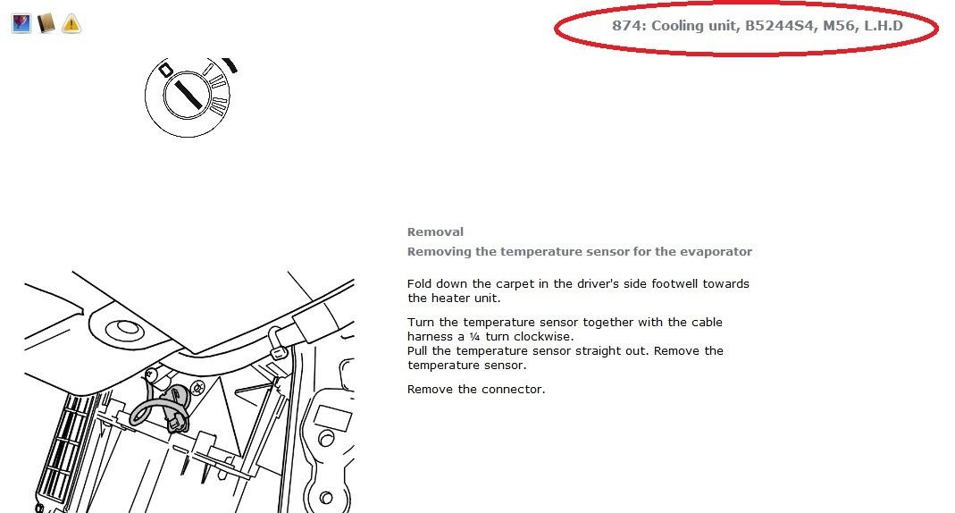

Due to the frozen pipes, I would like to rule out that the temperature sensor that measures the temperature entering the cabin is not defective (if this is defective, this can ensure that the air conditioning continues to cool until everything freezes over).

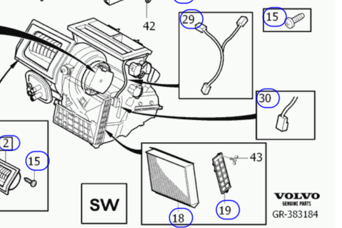

After a long search I found out which part I need for my car (30665322, part 30 on this picture) and where the part is located in my car (near the cabin air filter).
But the big question is: How do I get this one loose so i can install a new one?
The part is hidden quite high in the dashboard near the top of the hatch where the interior air filter is located. This makes it difficult for me to see clearly and feel what you are doing and how to release the sensor. Here is a photo of what the part looks like in my car.
Now the question: Can anyone tell me what I need to do to get this sensor loose so I can install a new one?

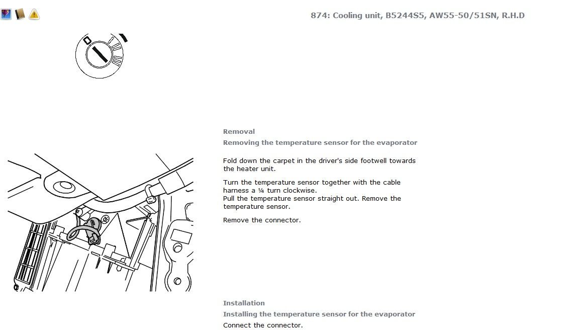

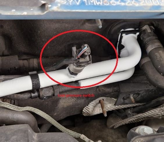

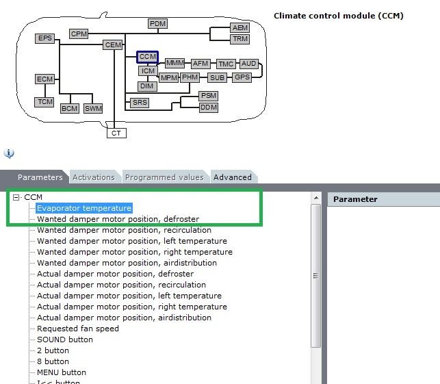

Have you considered actually diagnosing the problem rather than randomly replacing parts that you think might be bad? You can easily check the signal from the evap temp sensor with a compatible scan tool to determine if it's telling the CCM to keep the compressor on too long. Another possibility is the low pressure switch shown in your photo may not be turning the compressor off when the pressure gets too low. That would be checked with some ac gauges.
In answer to your question, instructions to replace the evap temp sensor are below.

Hi Hoonk,
Thanks for your reply! Yes I did not replace any parts yet and considered diagnosing first. If I know how to do it would definitely try. I have Vdash (with apropriat OBD adapter and a OBD2 general bluetooth dongle with neither of these methods I am able to find a reading for this sesnor.
First thing I wanted to try with this sensor is put it in the freezer to see if the resistance of the sensor changes when it gets cold. But to do that I need to get it out of the car.
The instructions you included in you post to remove the sensor are not for my car. You can see that on the parts diagram and on the foto the sensor looks differently and is much closer to the air filter then in the included instructions.
Are there the instructions from VIDA? Is it possible there are other institutions for my car model?
Really appreciate the help!

Originally Posted by Javdalen
Hi Hoonk,

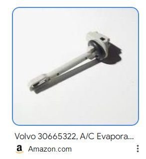

The instructions come from VIDA for the car shown below. And a picture of the evap temp sensor is below that.

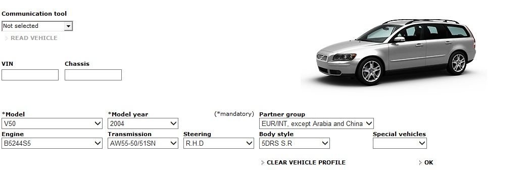

Is it possible it is different for a car with the steering wheel on the left and a manual transmission (I believe it is M56)? The rest seems like it should match my car....
Old Jul 15, 2024 | 01:49 PM
The hvac box is the same no matter what side the steering wheel is on - and trans does not matter, instructions are the same when those parameters are put in.

Today i had some time to check things. And with the diagram from VIDA you posted I found out that at the spot where on the diagram it shows the sensor I only have a screw and some sort of black tape....
You can see it in this picture I took. It is in the top-middle just left-below the thick cable.
Does anyone know if this is normal? Or should this sensor be here and is it a sign it got removed somewhere in the history of this car?

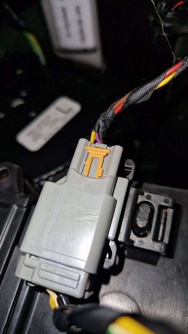

After finding this out I shifted my focus to the sensor in the low pressure part of the system as this sensor does not report to the computer of the car so there is no error code is this one fails and one of the symptoms of this sensor failing is a frozen airco.
I found out (with VIDA) that the compressor only shuts of (shortly) when accelerating but does not turn on/of frequently like normal.

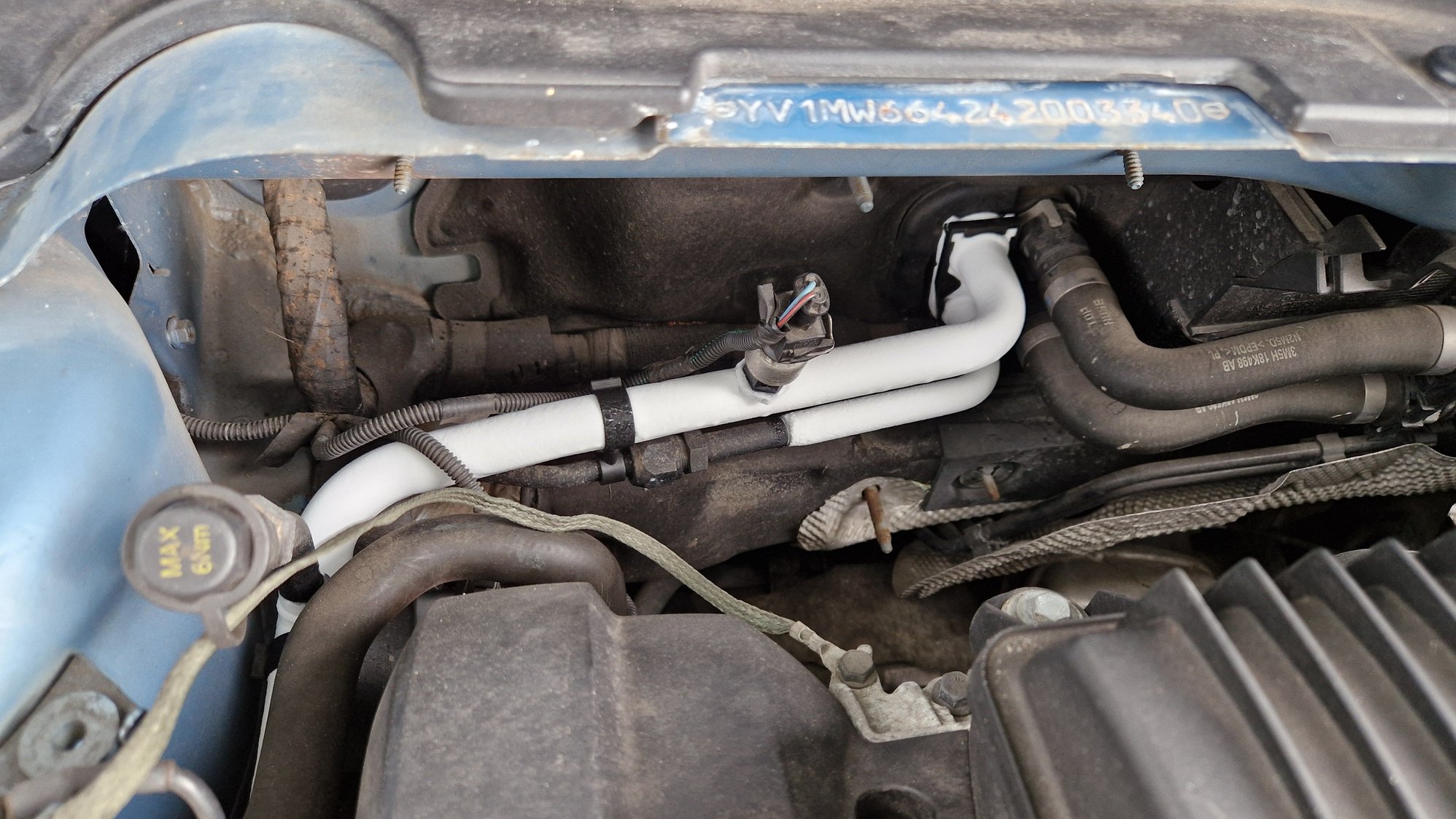

While checkin the low pressure sensor of the airco I found out that manipulating the cable to the sensor seems to influence the activity of the compressor and a few minutes later i found this:
I now fixed this cable and the airco is finally working! What a relief after years of problems with this airco.
