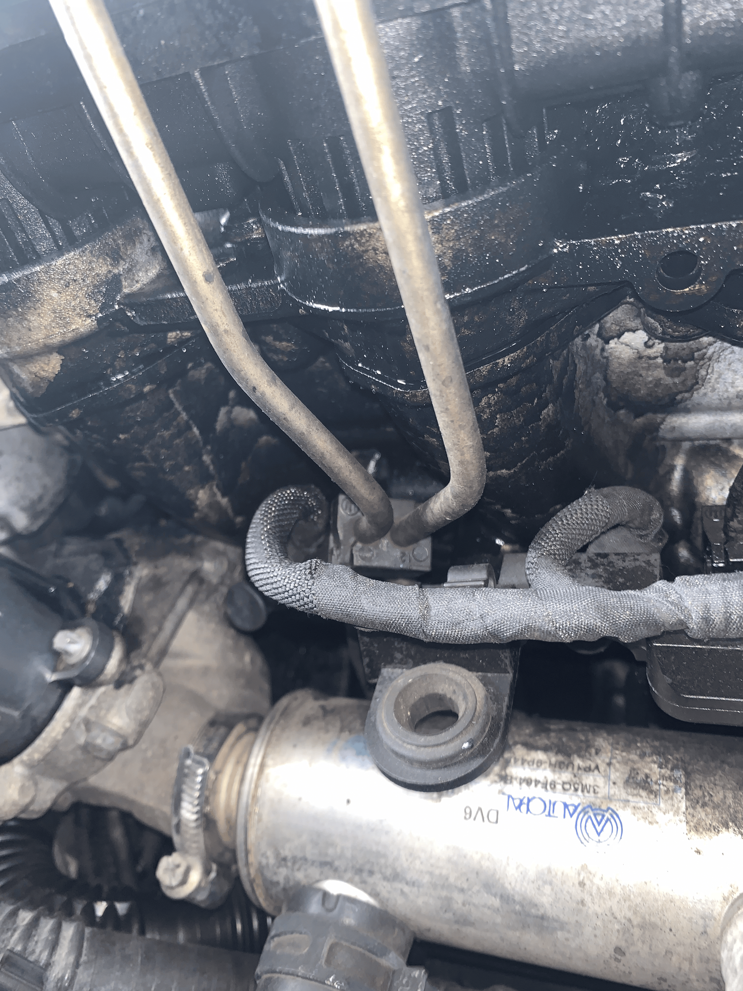

Hi, 3 weeks ago I have bought a used V50 for 2200EUR (1.6 TD D4164T, 80kW, 2008, VIN: YV1MW765282403530, 276kkm). The owner did only 15kkm in the last year and have driven the car very little. The oil filter, oil, air filter have been changed on a yearly basis. Otherwise the interior and body work is in pristine condition.
A couple of days ago I noticed the smell of burning oil and the AC not cooling the cabin (it was blowing but not cooling). I opened the hood and sure enough I found lots of oil leaking underneath. Oil is leaking from everywhere actually; well - out of every engine seal (crank, cam, injectors etc.). I have called three official mechanic shops and they have all told me it is pointless saving the engine, might as well buy a new engine and replace everything along with it OR dump the car and buy a new one.

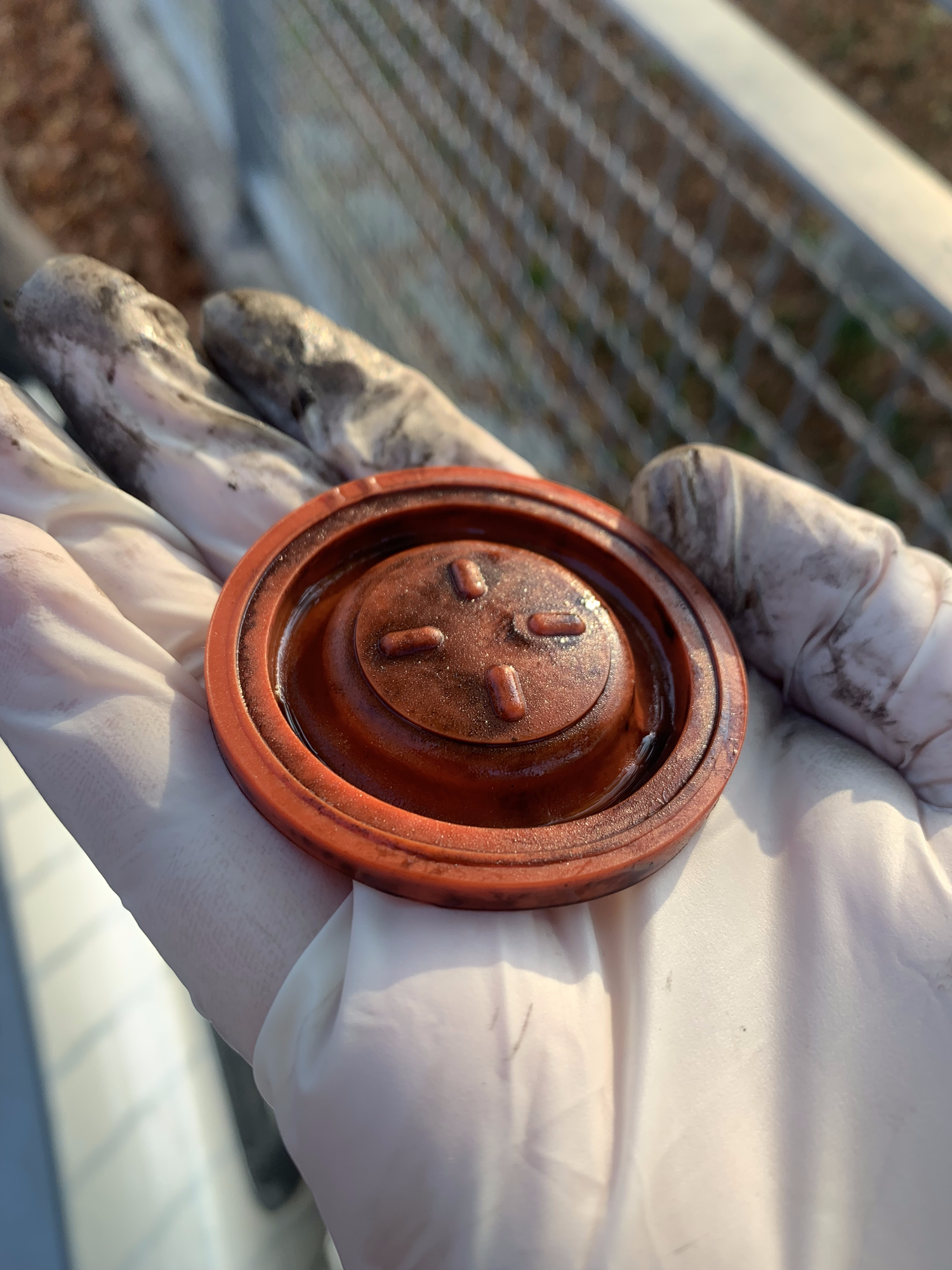

I suspect PCV blockage as I have put latex glove on top of oil cap and it had inflated instead of sucking it in. I have checked the engine block breather membrane today and it seems fine. I also suspect the AC is not working since the belt does not spin the AC compressor because of so much oil. Notice also the fuel injector no.3 is oily and others are clean & also i suspect the cylinder of the leaky injector is not producing any power. The engine is not producing any weird noises and it is not popping blue smoke in the back of the car. Also I have collected a lot of sticky black oil goo out of main crank pulley.
What do you think, am I missing something?
Should I replace all the seals, pcv, belt etc. / sell the car / buy a new engine?
Check the images AND VIDEO and please provide suggestions. Have a nice day!

Thank you very much for the answer and recommendations! I have done the glove test which you can see on the video. The back side of the engine is seen on the image below. Engine does not produce any strange smoke, noise or smell.... Any further suggestions based on the video provided?

Hi thank you very much for the reply! I figured the engine has an excessive pressure inside, however I have not been able to find the culprit. Right now I think these could be responsible:
  • bad piston rings -> the compression test or the leak down test should be performed to find this out,
  • clogged pcv/engine breather system -> will have to replace entire valve cover/pcv or find blockage in the pcv hoses, as the membrane is ok,
  • leaking turbocharger oil seals -> turbine blows compressed air through oil return lines to the crankcase.

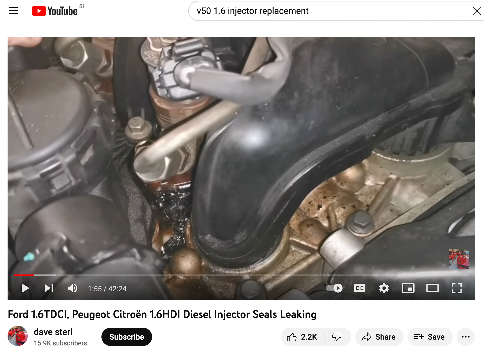

Also check this video for further analysis.

Also, they say that the oil on top and around injectors is completely normal as this is essential to lubricate (weird.....&#129300. However, If you check the pictures it is evident that the no.2 injector is significantly more dirty than other injcetors, leading me to a conclusion that it is faulty somehow which they (mechanics) did not notice apparently.

In regards to the oil leak: I find it difficult to understand that the engine would be that wet at 276k km. As seen on the image below, the space around injectors should be dry as a Sahara desert unless the injectors are to be replaced. Comparing the imege below to the images of my engine the difference is clear... What do you think? Also if you look at the picture of my engine, the injector no.2 is clearly more dirty than other injectors.
