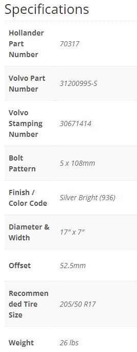

The difference is in the width and offset. This should tell you what you need to know:
Spartacus:
Sadira:
