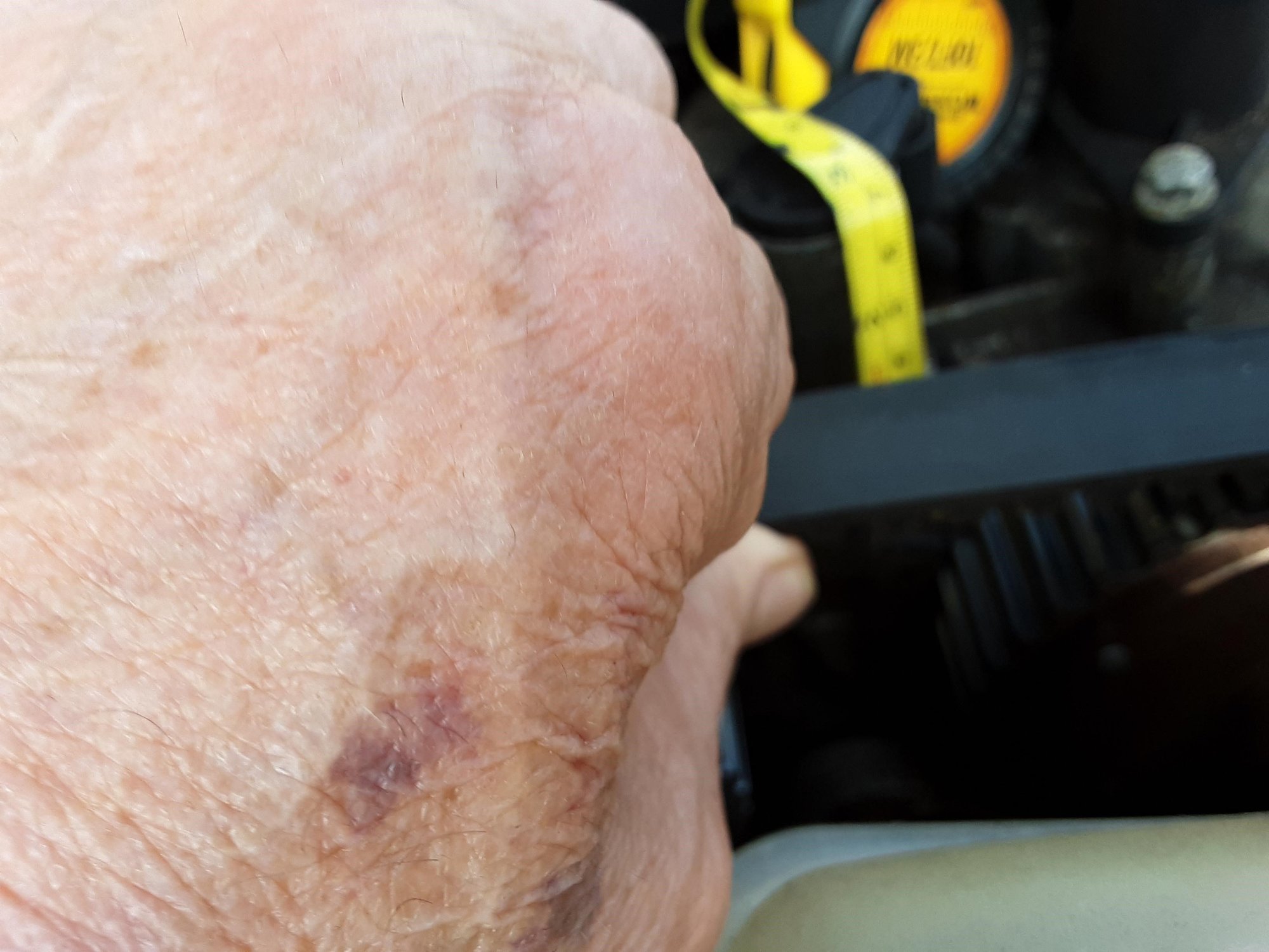

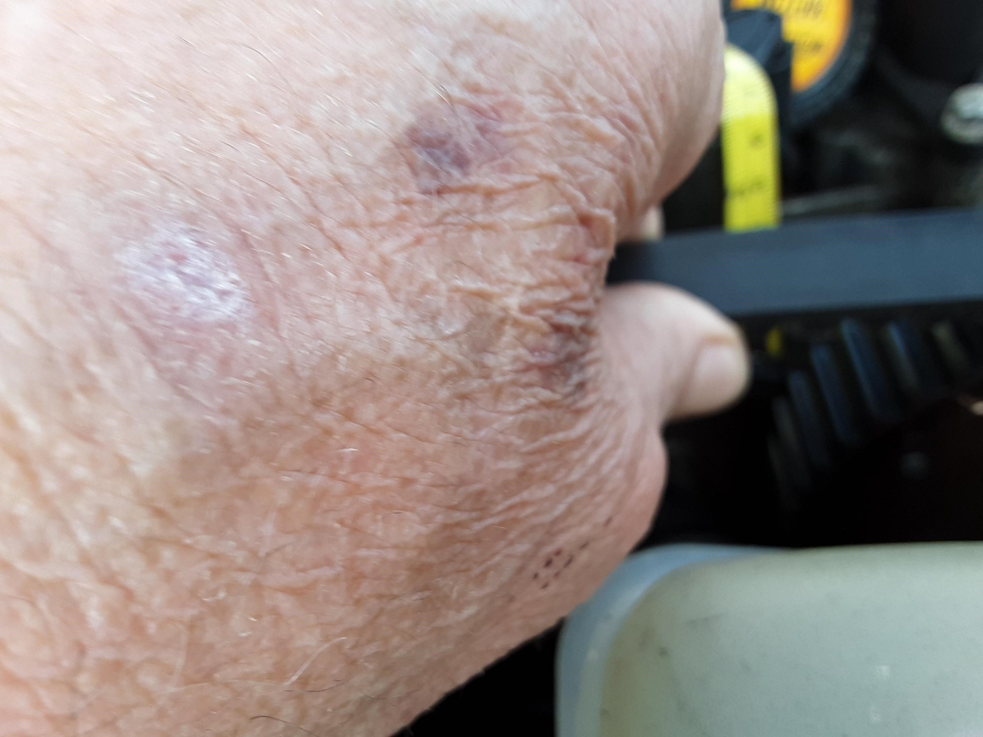

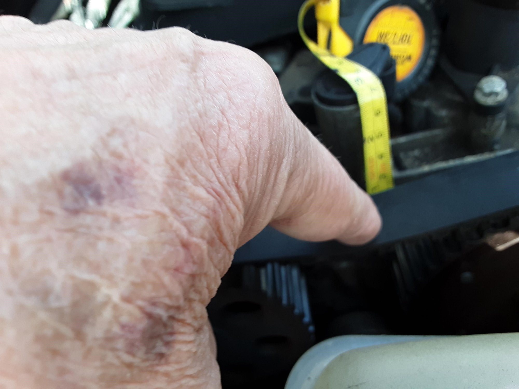

Default I have got the cover off and the Timing belt is on.
The belt is on and the play between the 2 top pulleys is 1/2 an inch . Probably a tensioner and it jumped ?? Here are pics of play. I did notice the alternator belt looks to be shreding, I replaced 6 months ago.

I have repaired several cars where the serpentine belt comes apart and pieces get caught in the timing belt - causing the timing belt to "jump time" with the resulting bent valves - it's still possible there are no or just 10 bent valves.
