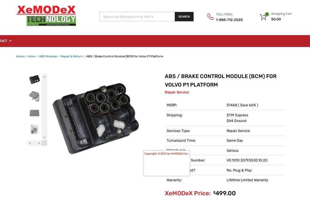

It is common to have abs sensor faults - but usually it's not the sensors - it's connection problems inside the abs control unit. (techs read the codes and "replace by code", rather than solve the problem. And it's certainly possible to have a damaged abs sensor, or tone ring on some cars) The control unit is "programmed" to the VIN number of your car - meaning usually a used part will not work. Companies such as xemodex ( unfortunately they are in Canada) can fix your ABS control unit. New ones from Volvo are very expensive and require a software download using VIDA to make them work.
The first step would be ready codes again - and maybe find someone to fix what's really causing the problem.
