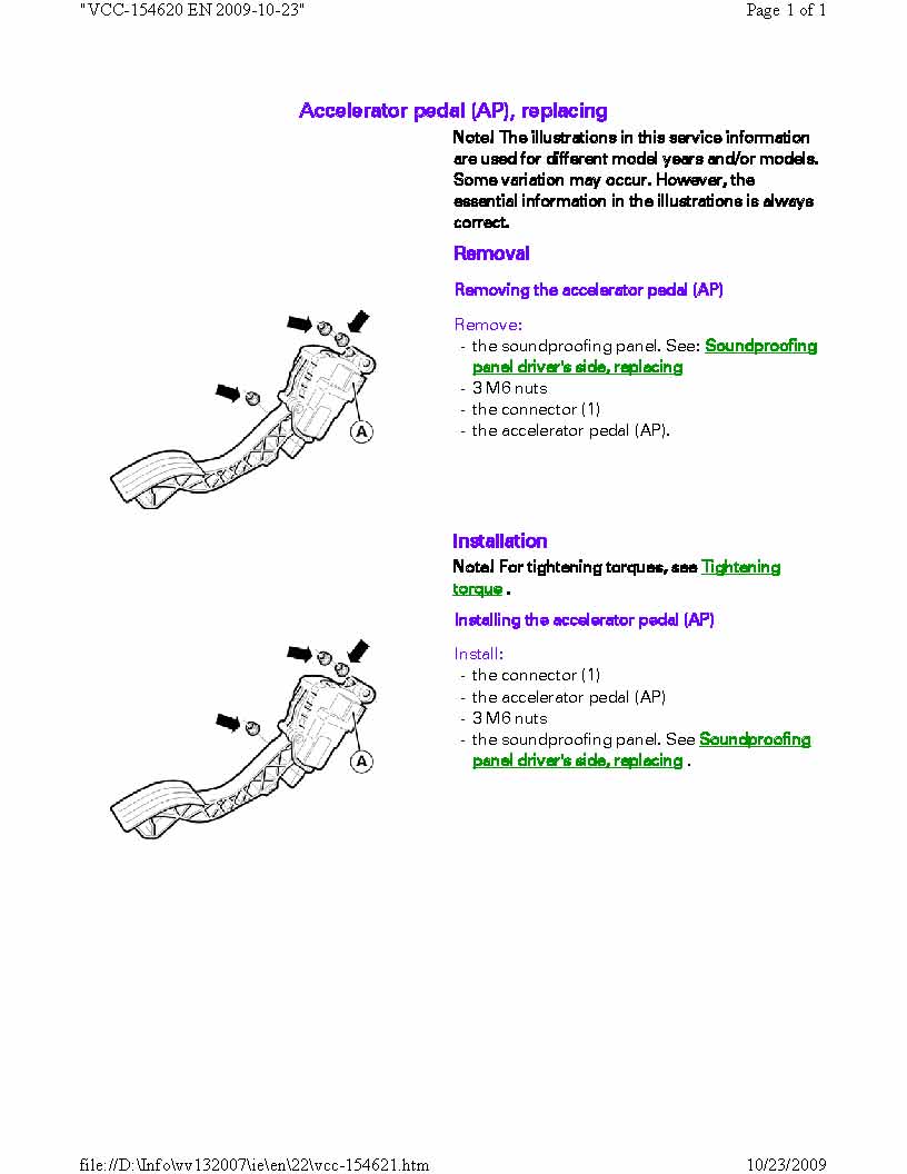

The link you have above is for a S60/V70. Here is a link with a How-To for the 2004.5+ S40/V50. And the official procedure.
http://forums.swedespeed.com/zerothread?id=116825
Stan
Attached Thumbnails V50 Cabin Filter Location-2005_s40_soundproofingpanel_page_1.jpg   V50 Cabin Filter Location-2005_s40_soundproofingpanel_page_2.jpg   V50 Cabin Filter Location-2005_s40_cabinfilter_page_1.jpg   V50 Cabin Filter Location-2005_s40_cabinfilter_page_2.jpg   V50 Cabin Filter Location-2005_s40_acceleratorpedal.jpg
