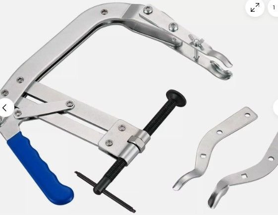

Unsure which Model of Valve spring compressor to Buy for S4 Head to change Valve Stem Seals.. any Pics appreciated.

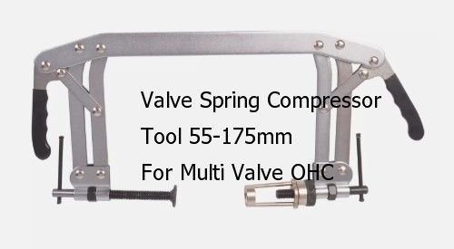

If you really want to be able to remove your valves - and it's a Volvo aluminum head with DOHC from ~1992 - present - you will need the lower picture. The valve springs are recessed and you will need an extension as pictured to be able to depress the spring and remove the keepers (to be able to get the springs off and the valves out)
BTY - changing your valves stem seals is NOT going to reduce your oil usage! (if that's why you are seeking this solution!)

Thank you. for this advice . . We are Overhauling an Un Know Volvo V50 which needs a Head Gasket Replaced so while the Head is Off, we are doing the Valve seals at the same time. just to renew them

We did buy the One you quoted and it woks very well. Thank you
