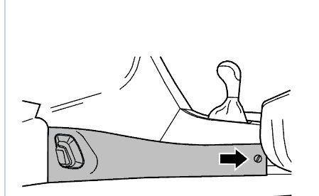

To get the shifter out of park - take the lower side panel off the console on the drivers side. (1/4 turn on that arrowed plastic screw) Find the small black cable that goes from the steering column lock to the shifter. Move the "spool" (circled in red on the illustration) out of the "fork" holding it. Just push the spool up. If you move the cable forward after that (or backward, don't remember) that will release the shifter, as long as the key is on, your foot is on the brake and the shift release solenoid still works. You can feel the shift release solenoid click in the shifter to make sure it is working. Turn key on, gently depress brake pedal - you should be able to feel a click in the shifter when ever the solenoid works.

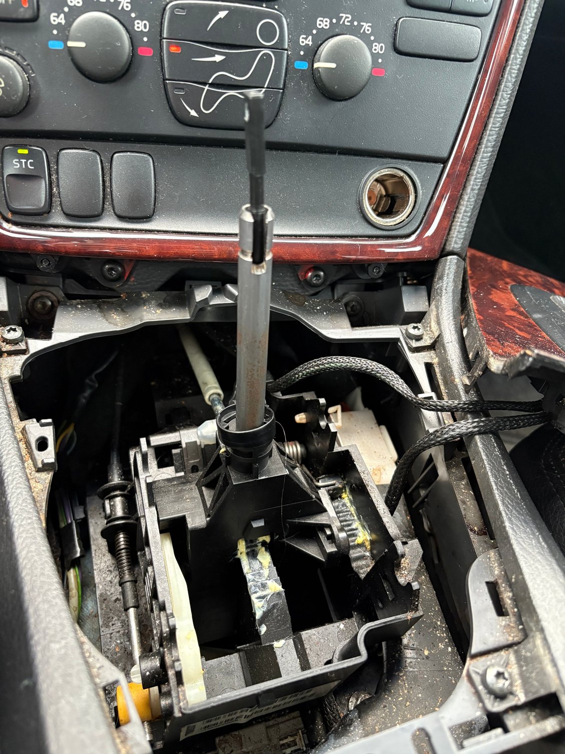

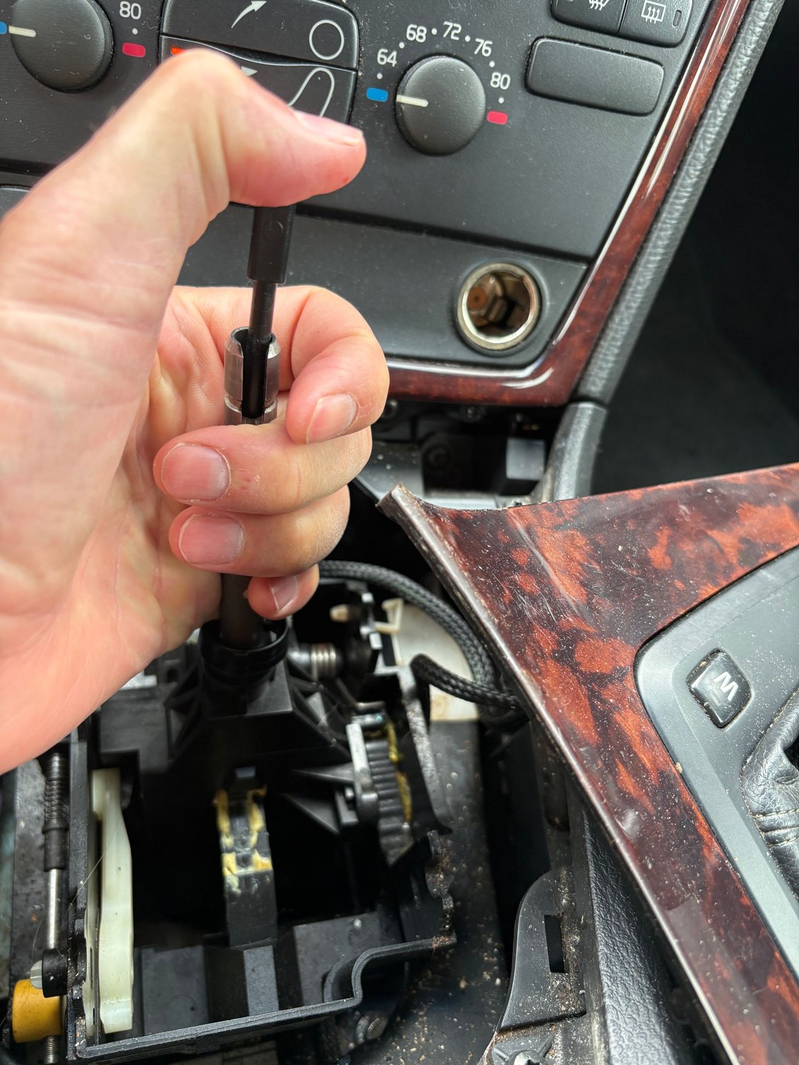

Default Can’t move shifter but lock mechanism working
I was in the process of replacing a broken button on the shifter. I pulled the shifter off but now can’t activate the shift mechanism with the linkage rod. When I push it down it’s solid- there’s no depression, so the shifter is stuck. The white lever lock mechanism works as I see it lift up when I turn on the car and hear a click when I depress the brake. Any help much appreciated. I feel like I can’t buy a new shifter until I can prove that this is actually going to work.
