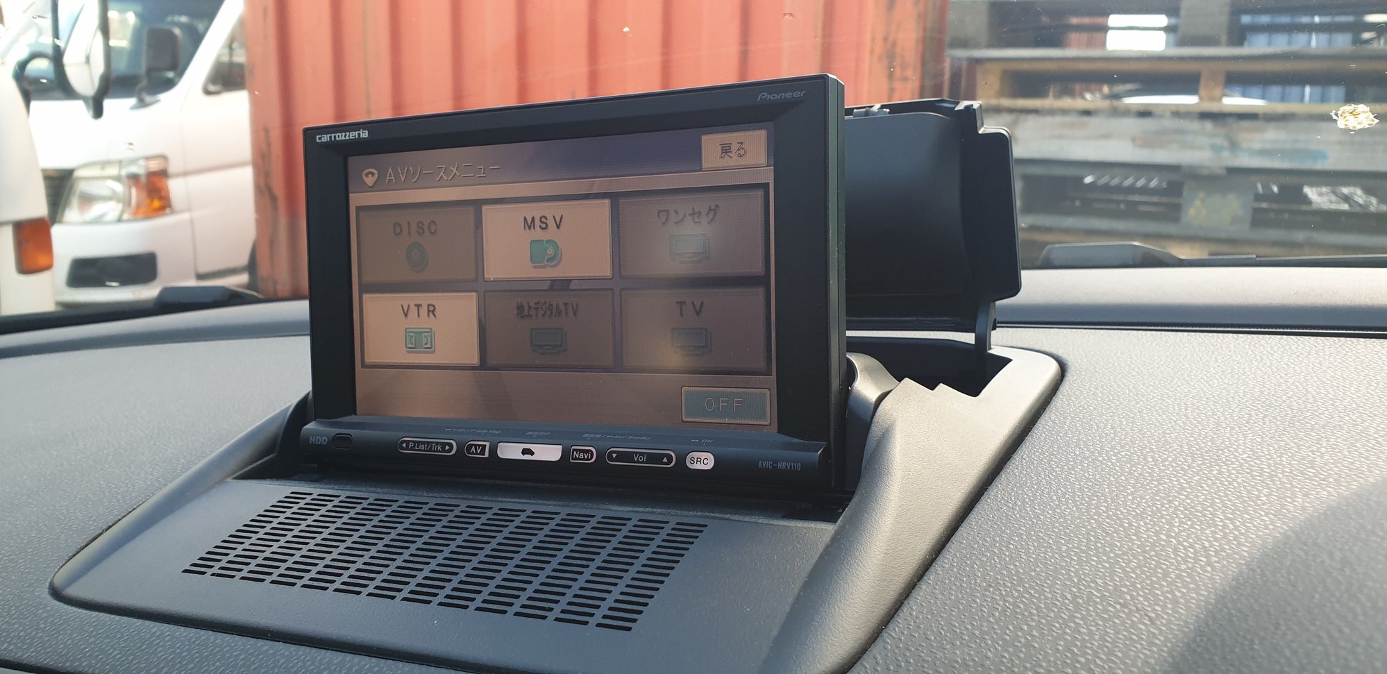

I did rip mine out. :-) I gutted the screen, fitted a capicitive touch screen into the case and I have a Raspberry Pi running Android Lineage OS with my own music player app connected to the AUX port. So much more useful now! I did break the touch screen so I can't use the top vertical quarter, but it does the job.. I just moved all my touch buttons to the working area of the touch screen lol
Here you go:

bro that looks amazing. was there enough space inside the unit to fit the aux cable as well was there? Good job man! might have to do this. I appreciate the reply and photo! Going to be a bit tricky on my V50 as my screen doesn't rise, it flips forward manually.
Cheers man. Was there a guide you used to help, or did you use your number 8 wire style and do it yourself?
Old Aug 12, 2022 | 11:08 PM
SparkyNZ's Avatar
Joined: Nov 2017
Posts: 21
No worries. I just did it myself - no guides. The worst part was pulling out the stupid DVD unit that stole all of the glovebox space. I had to take the entire glovebox out to get access to the mounting screws holding that horrible thing in.
You would be able to achieve what I did with the flip-style screen as opposed to the vertical rising style. I hacked the touchscreen controller board a bit to make it fit and (since I broke the original trying to move the HDMI port lol...) I ended up buying a new screen controller from eBay.. some ribbon cable extenders.. The nice thing about mine having the "riser" is that there was a little bit of space underneath the "grill cover" to route some wires. I ended up drilling a hole in there to feed the wires into the back of my glovebox where the Pi sits happily.
The biggest problem with this "solution" is that the Pi doesn't have a battery backup and it takes a while for it to boot up. I just had a spare Pi 3B and wanted to make use of it. There is a 12V USB power supply that I bought - I was lucky enough to steal the 12V supply from the ETC toll gate card reader for that. It really was a big hack though! I only use the XC70 for long trips so it does the job.
As for the AUX cable lol... I had a mini jack socket in the back of the centre console (between the seats). I just ran a 3.5" male to 3.5" male cable underneath the console and fed that into the back of the glovebox too and into the Pi.
