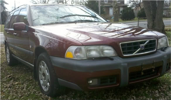

Now Maryland State inspected, tagged and on the road.
2000 Volvo V70 Cross Country
180K miles
Clean, tight and the turbo makes it surprisingly quick.
Garage kept and the original paint looks great.
Allegedly female driven from Maryland to New England for weekly antiquing trips. Sure.
$2300.
I got it for $1900 but had to update some stuff for the inspection. The P.O. promises to reimburse me but I'm not holding my breath. I was originally going to pay him $2300, knowing that it needed the additional $400 work but I held out until he finally offered it to me at a price that essentially included the repairs.

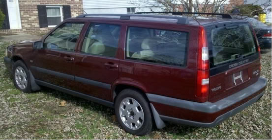

It will replace the green '97 Avalon in the background now sporting 316K miles and a serious case of terminal rust. Broke my heart. That car wants to go forever.

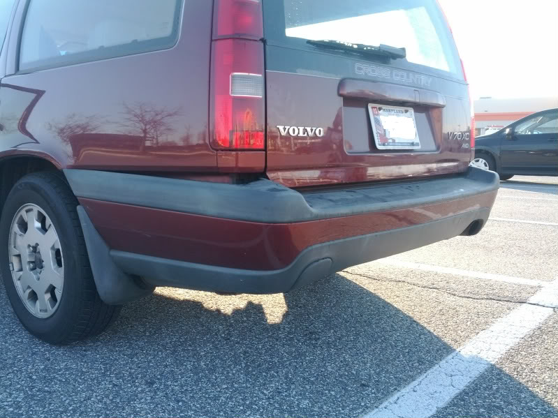

Well, crap!
The guy behind me at the flashing red light (it means STOP!) thought that I had gone and made his move...right into my rear bumper.

Dig, that bumper boo-boo breaks my heart.

Thanks, az. Right now, I'm having trouble with the other guy and his insurance. They try to call him but he doesn't answer the phone. They say they can't authorize repairs without speaking to him. I was advised to try calling him and asking nicely. He answered and seemed entirely reasonable and said he'd be glad to answer their questions. That was 3 days ago.

Sorry about the recent ding, he needs to CALL HIS INSURANCE company and get that taken care of. My daughter was swipped in her car and the old lady had no remberance of any accident. Good thing she had a police report. ALWAY CALL THE POLICE.
