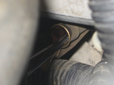

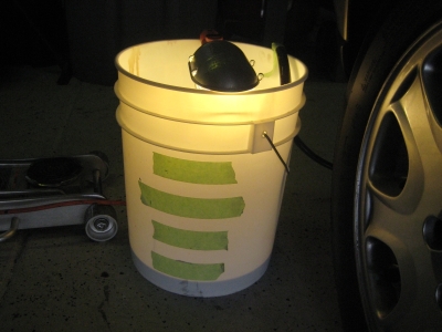

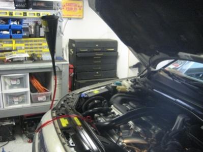

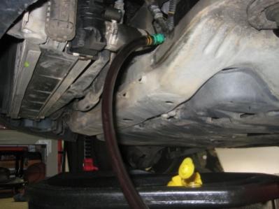

Default I wrote up a more detailed procedure
So I got a little ambitious and created detailed instructions with images on how to flush the transmission. If the Admin wants to post this on the sticky in the S60 forum, it is fine by me.
Drove thre car around the block and a small stretch of highway. Feels much better now. But I want to give it a week or so to see if it really helped.
Well, never mind about the PDF. For some reason the limit is set to 19KB of file size, which isn't much at all. Don't have time to rewrite it. See attached images. I have it all on PDF if you want me to send it to you though. Only 109KB in size.
Attached Thumbnails Lurching transmission-drain-attachment.jpg   Lurching transmission-fluid-supply.jpg   Lurching transmission-fluid-drain.jpg   Lurching transmission-supply-attachment.jpg   Lurching transmission-drain-monitor.jpg

Hello, ChrisAce, which connection did you use for your flush? It seems smart to exit the fluid low to the ground. The one thing people never refer to in these transmission posts is the high likelihood of a local mechanic or PO using the wrong fluid. A local big name lube joint near me never heard of 3309 and acted like I was some high school drooling over a brand of motor oil. Also, the bulk fluid dealer used by an old pal who has a transmission shop 30 years never heard of the stuff. I gave him a Toyota TYPE-IV and Mobil 3309 bottle for reference. He will R&R a 5 speed for ~$3,500. He's in No. New Jersey. Kira
