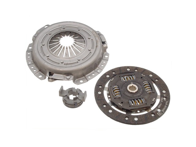

You need a clutch kit. It should consist of the clutch disc, pressure plate and throw out bearing. It may or may not include a pilot bearing. Depending on it's condidtion you may also want to machine the face of the flywheel. It's like a brake rotor and pads. Over time the friction disc will eat into the face of the flywheel and can make it uneven or scored. It needs to be flat and smooth to function properly and allow it to engage smoothly and to have the capacity to hold all the horsepower without slipping.
Clutch Kit Non-Turbo 1993-1998 850 S70 V70
Attached Thumbnails New (to me) V70 5 speed manual, slipping.-clutch-kit.jpg
