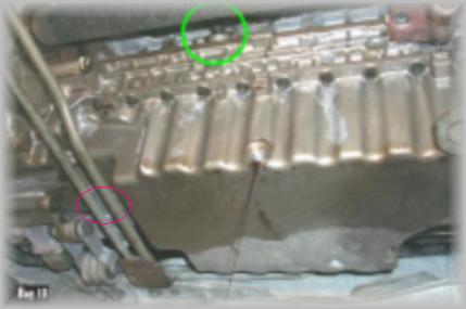

So I finally got under the car today, and I noticed that these two lines were leaking (circled in red). Also, the backside of the oil pan is also pretty wet. I couldn't see if the o-ring was leaking. My question is, what are those two little lines?
Sorry if it's a dumb question.
Thanks again
Edit: TO BE CLEAR: those two lines aren't leaking, they are just collecting oil and dripping from the bottom of the lines. I just wanted to know what those two little lines are.
Thanks

Those 2 lines are the power steering lines.
So if the turbo drain line was leaking, would it make its way down to those PS lines? I just can't see for sure that the drain seal is leaking.

It could but it would be between the motor and subframe that was wet.

I got a flashlight under there today, and I saw that the drain line was wet from the block for about 3 inches above it. Then the rest was dry all the way up to the turbo. I'll get that o-ring replaced for sure. So from the instructions my search has netted, it seems like I need to unbolt that clamp, then the two bolts that hold the line to the turbo itself, and finally wiggle the line out of the block?
