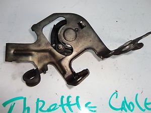

Smile Stiff gas pedal. Not caused by cable but pulley springs.
Hi I am a new member but old Volvo fan, My first was a 1959 544 when I was 16. Since then many others, 122 145 many 240's curently 1990 740 wagon 16 valve and a just purchased 1998 S70 with 186000 miles.
I love this S70, very quick and comfortable.
What brought me to the forum is the stiff hard to press gas pedal. I read in another forum to replace the throttle cable, I was about to do that when I thought I would try some wd40 on the cable before buying a new one. when I detached the cable from the pulley I found that it moved quite freely. I decide to disassemble the pulley actuator (see photos) to see if the springs could be adjusted because they seemed too strong. There are two springs, a large spring and a small inner spring there is no adjustment, the spring position is fixed. I removed the small inner spring and re installed the pulley and cable and it now feels like a normal gas pedal.
Attached Thumbnails Very stiff gas pedal-%24_35.jpg   Very stiff gas pedal-%24_35-1-.jpg
