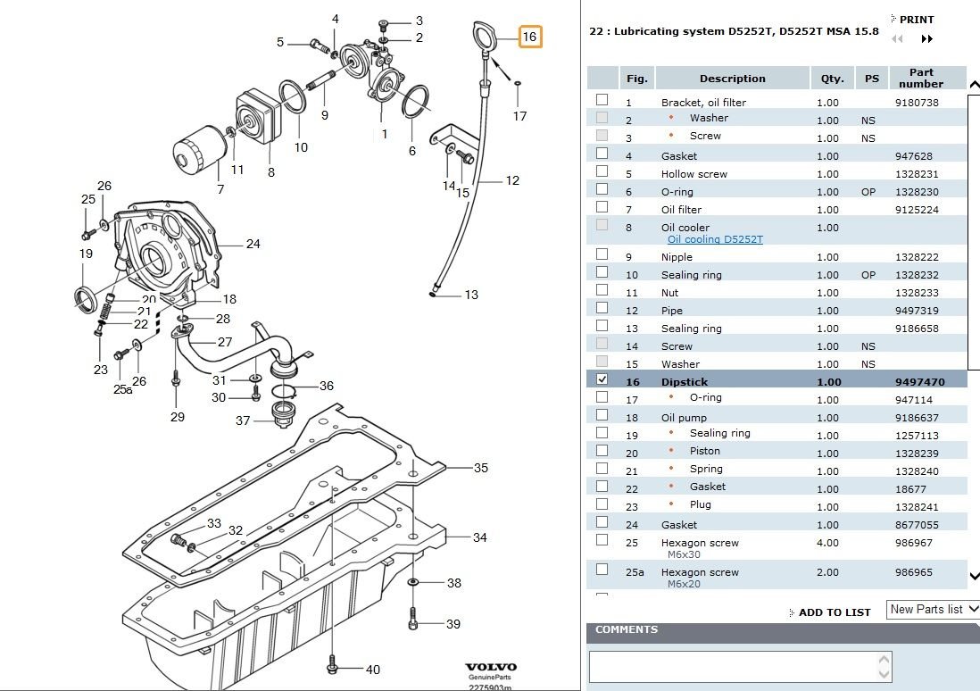

Your best choice would be to contact a Volvo dealer for the correct part - two choices for dipsticks 9180736 or 9497470 depending on VIN#. The first parts page is for the 2000-2007 cars, second page is for the 1998-2000 cars.
