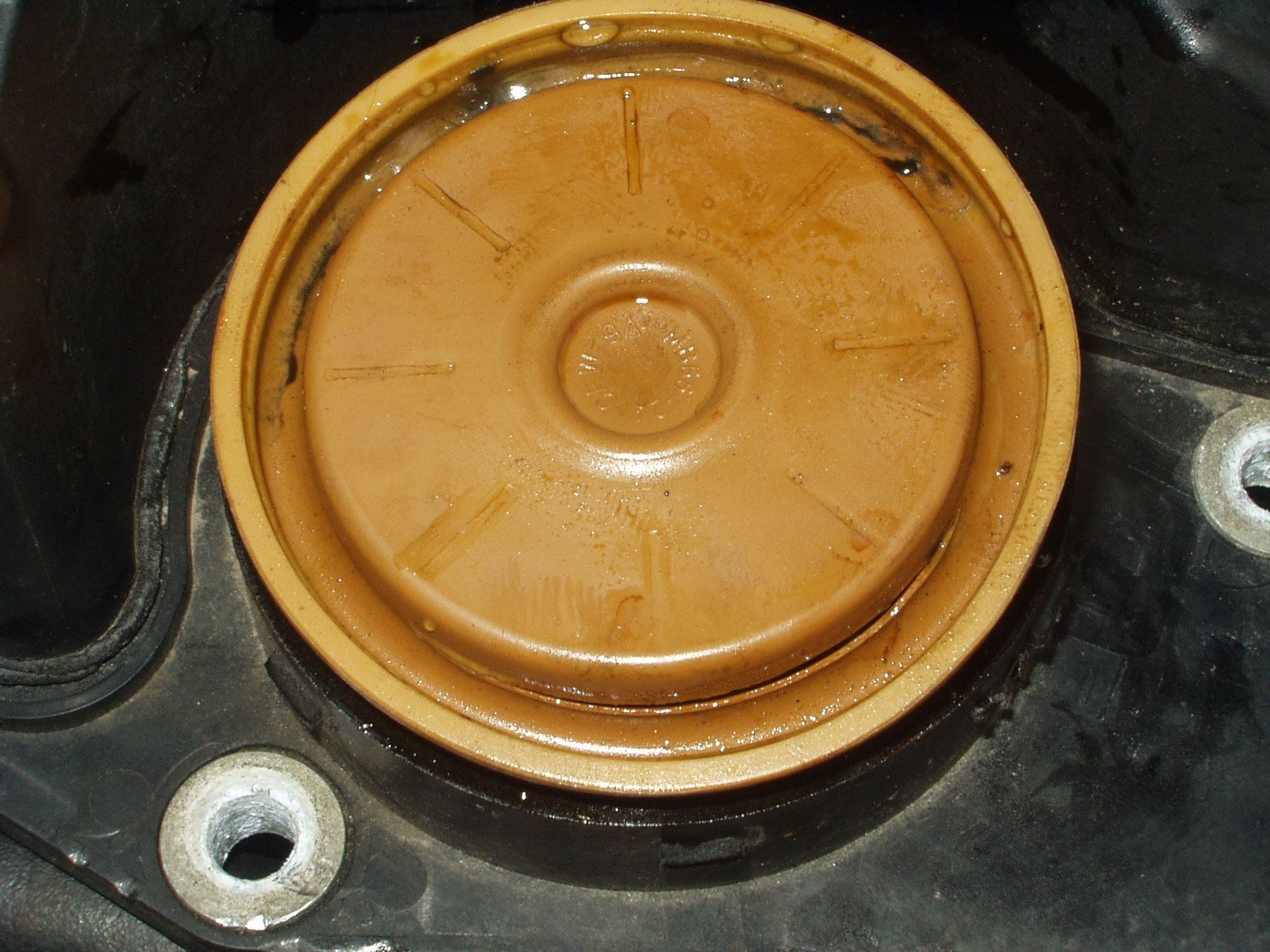

Well, for $270 they did a five minute oil mist test and said it was the air-oil separator. Changed it and now have misfires on cylinders 1,2,3,4,5,6 and random. Went back to the independent shop Foreign Sports and now they say that is the first of things to replace. I thought paying to have a diagnosis was everything, not try that and come back and pay more.
Pulled the cap off the original separator and found the diaphram has a split.
You realize that Ford could have just made this small diaphram replaceable instead of the whole box for a lot less than the $200+ that Volvo sells it for.
Checking the replacement separator (PPS) from AutohauzAZ, air flows both ways through the port. I have to check with them to see if that is correct. The very light spring under the diaphram holds it up off the port. there is a small hole in the cap. Presumably, when the outside air pressure is greater than the crankcase pressure the valve will close. Not the usual PCV that I am used to.

Thanks. I replaced the MAF and cleaned the throttle body. The MAF is next to the air filter which is far upstream of the throttle body. I do not know where the crank case vapors are fed into the intake stream but it must be downstream of the throttle body.
This air-oil separator is just a still air box with a long narrow tunnel leading to the diaphram port. Without the box on the engine there is a strong pull of air through a hole into the cam chain case. If the problem is that the engine cannot pull enough vacuum to close the port and causing too much air going into the intake, I can try plugging the port and see if that fixes the problem. I can use the old separator and put a plug in the port.

Plugging the port on the old separator and putting it back on made the engine idle better but still has the codes misfire on cylinders 1,2 4,5,6 and random.
