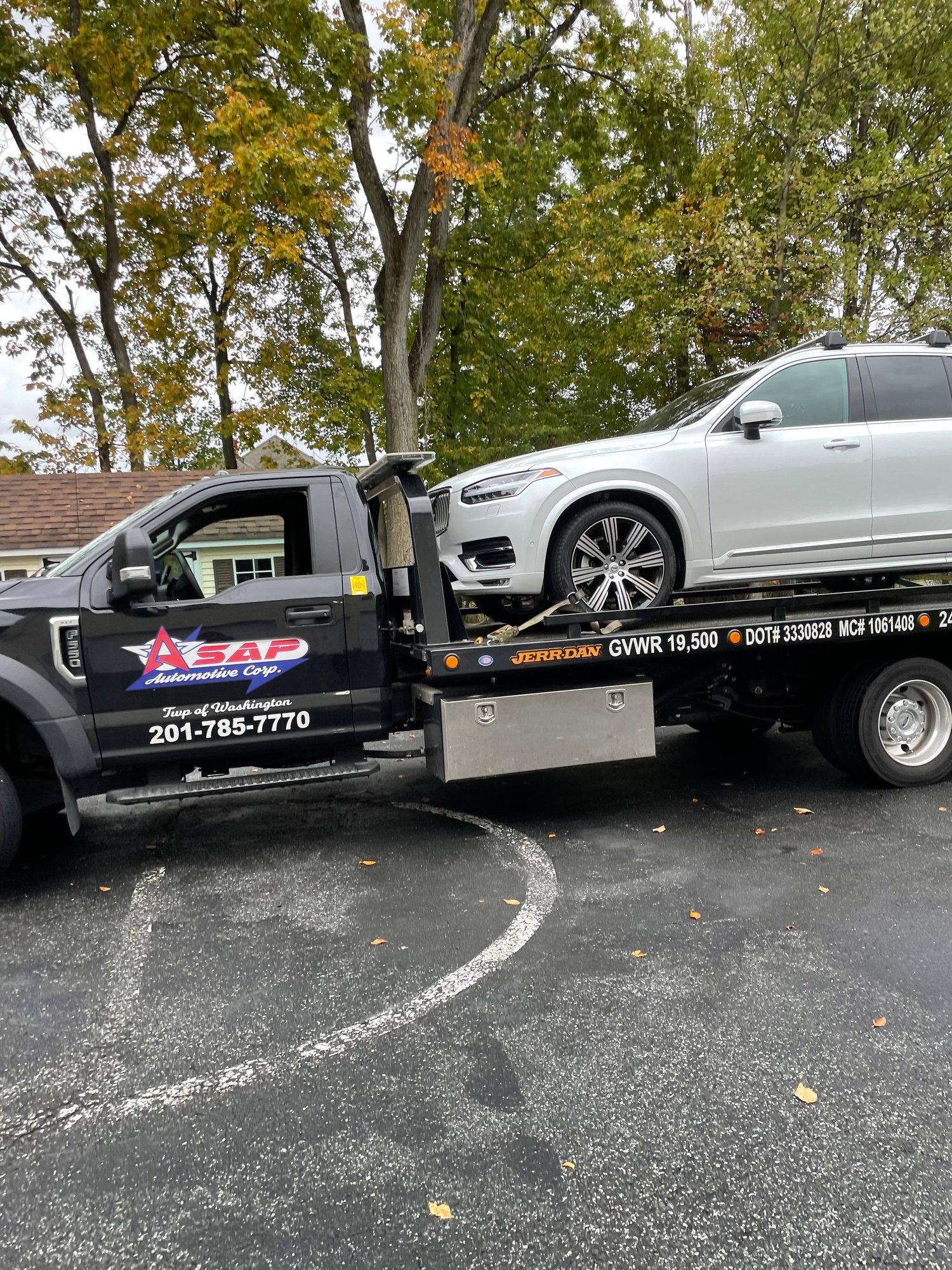

I got the car 10 days, it went completely dead. After jump start “12 v battery critical charge default. Now it was towed to the dealership. They did not provide loaner car.
So upsetting!!! Thank
