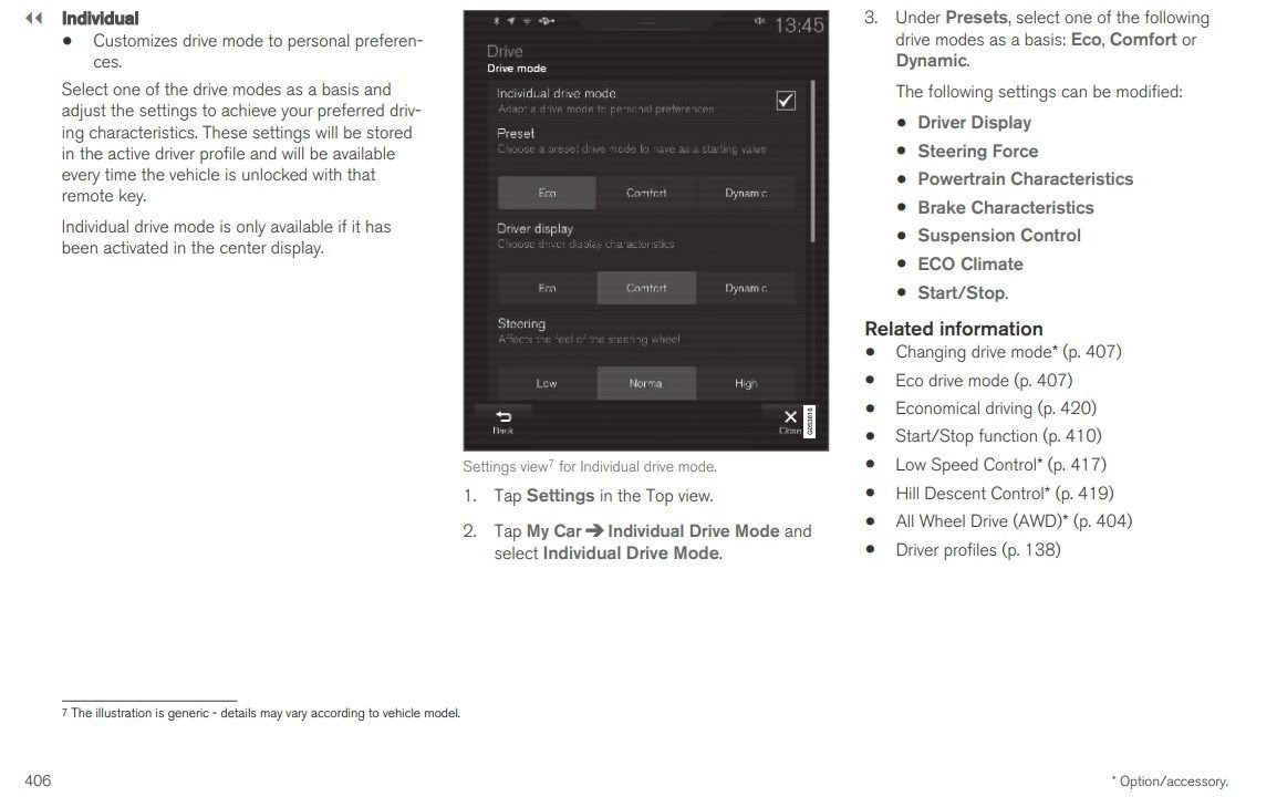

Can you create an individual driving mode and change the display to dynamic? - as shown on page 406

Yeah, so no go on this one. This car doesnt have a drive mode selector in the mid console. And electronically not available through on screen menu.
