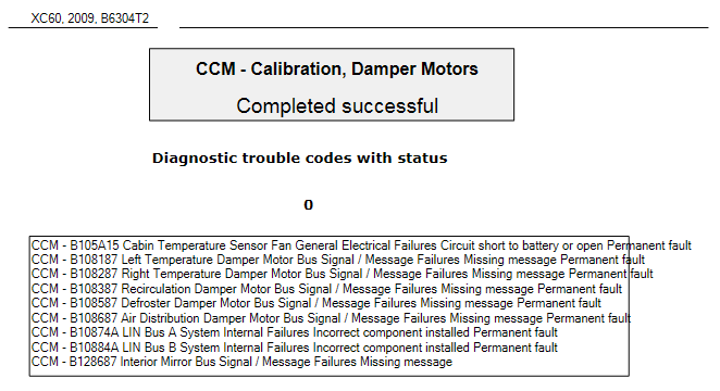

The following is info from my VIDA 2014D.
1. Perform Diagnostics as follows:
- Select the "DIAGNOSTICS" tab followed by the "DETAILS" tab.
- Click "UPDATE" button.
- Select the "FAULT TRACE" tab and get the following info.
2. Perform calibration of the CCM as follows:
- Select the "DIAGNOSTICS" tab followed by the "VEHICLE COMMUNICATION" tab.
- Click to highlight the "CCM" box.
- Select the "Advanced" tab.
- Double click "CCM".
- Click to highlight the "Calibrating the Climate Control Module(CCM)".
- Click "DESCRIPTION" button.
- Click "Yes" button if to continue with the calibration.
- Read and follow the instructions (to the right) carefully, Ignition on and click the VCT2000 symbol (to the left) to do calibration.
- Click the "Start" button (left on screen tool).
- Wait 30 seconds until status "Completed successful" is shown on the screen tool and get the following info.
- Click the "Hide" button to continue.
- Click the "Continue" button to proceed.
- Ignition off
( Same result if pulling fuses #32 #33 off to perform calibration of the CCM )
