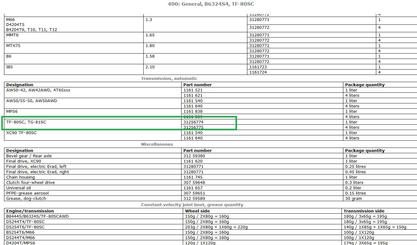

Volvos part number is below, type "WS"

it is the TF80SC

It is the TF 80SC tranny

My last 6 chassis numbers are 406830 which suggest fluid T-IV in the TF 80 SC tranny, according to SwedeSpeed. SwedeSpeed claims that type fluid WS is a good middle ground. Since I live in warm southern Calif, hot temperature is what I should worry about. I was wondering what your thoughts were?
