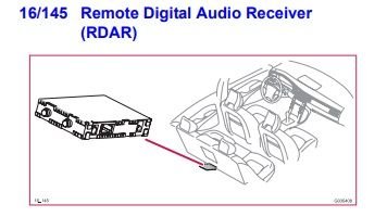

Originally Posted by Rob_Jones
non-working radio. I got a replacement but it didn't make a difference.
What part did you replace? The icm or the iam?

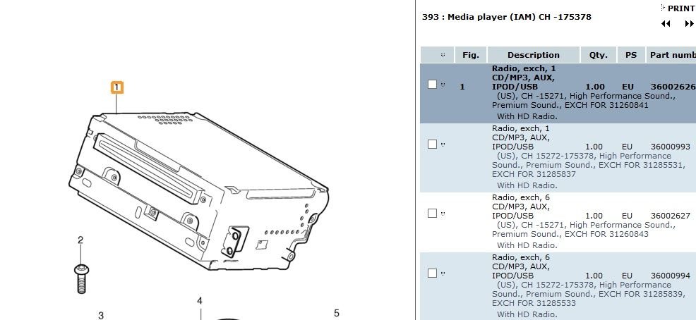

I replaced the Media Player (IAM). My car doesn't have an ICM like the one pictured. This is what my radio looks like.

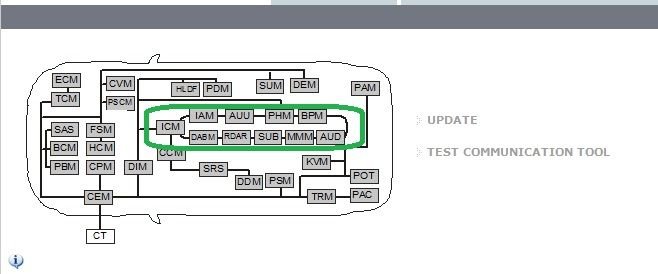

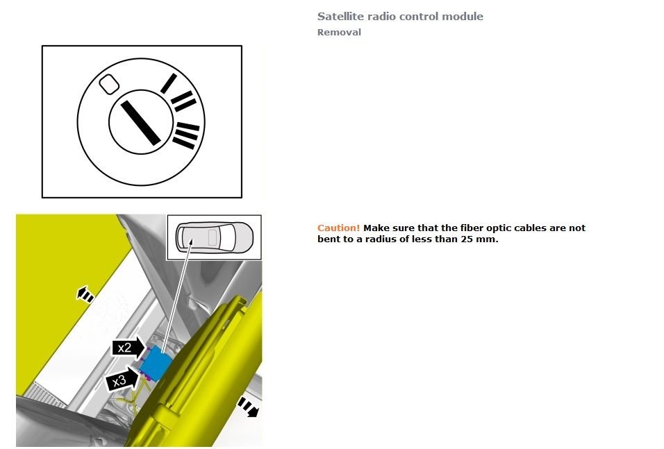

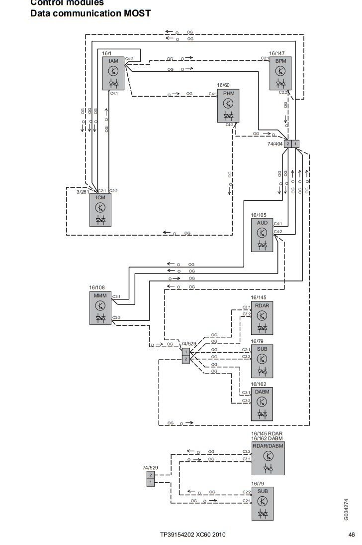

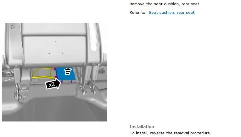

Here's info from Volvo - They show all available modules in the diagrams - I doubt you have the PHM, phone, MMM multimedia, SUB, woofer and others. Note the most data communication is through the orange fiber optic line - and if anyone is disconnected - none of them work.

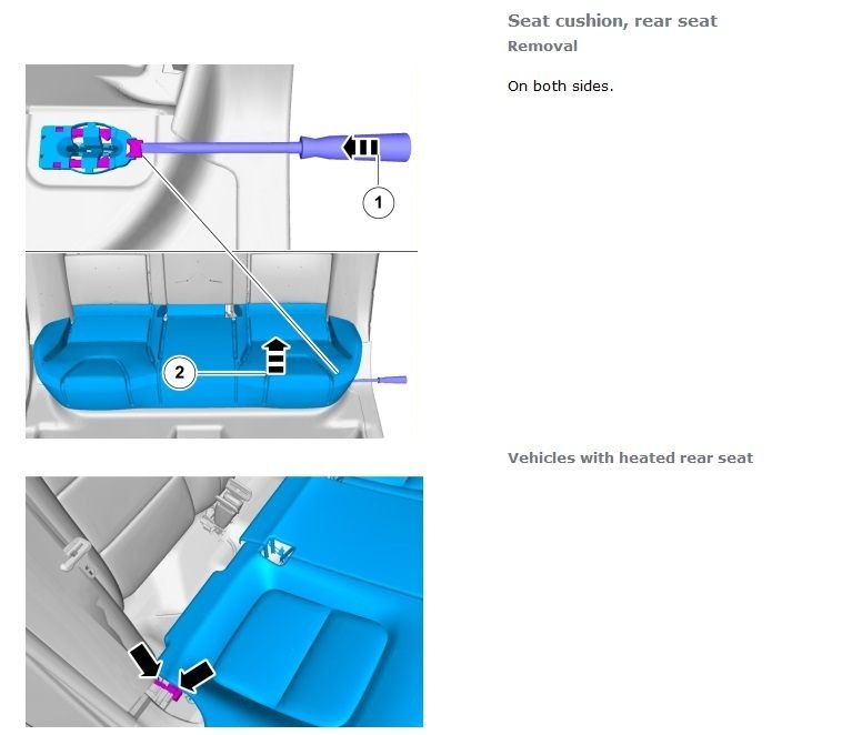

Aha - so it's under the rear seat! OK! Now I know where to look. Thank you!
