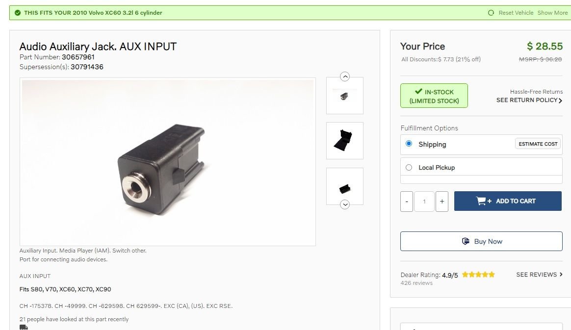

Does your car have this type of aux input jack?
Old Feb 15, 2024 | 04:13 PM
Alexandr's Avatar
Joined: Feb 2024
yes, this is the aux
Old Feb 15, 2024 | 05:23 PM
If that's your aux input and it's broken - why not simply replace the broken 3.5mm aux input jack? Is there something I'm missing?
