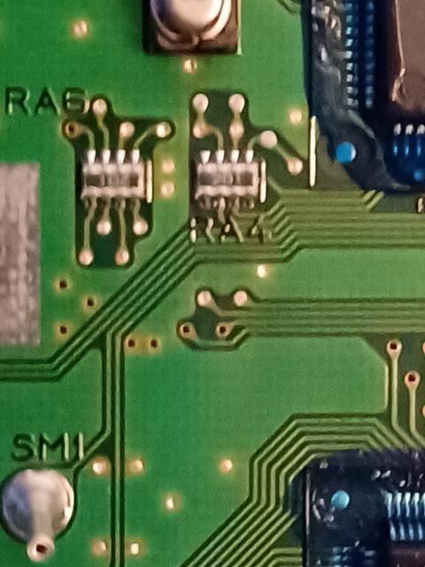

2003 Volvo xc70 instrument cluster.
removed cluster from dashboard to inspect.

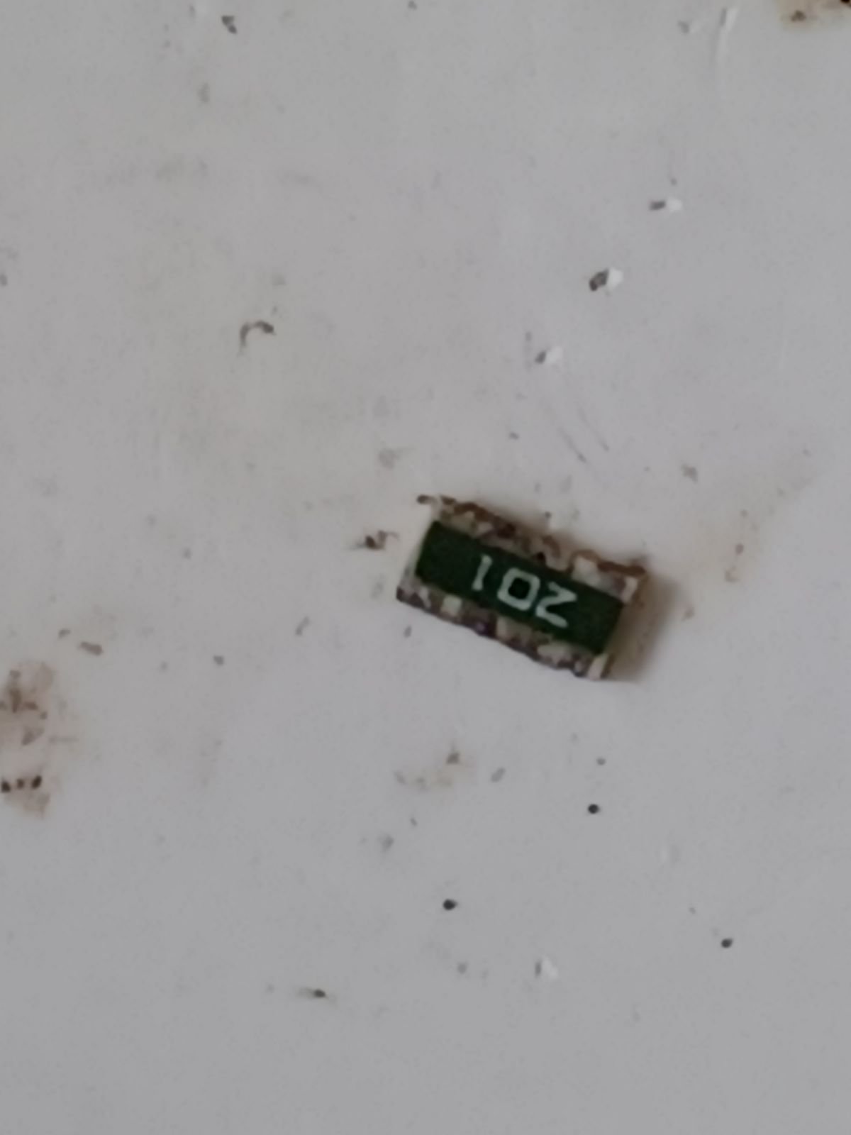

observed each RA6 and RA4 circuit paths a "201" smd chip(resistor) soldered into them.
the resistors are no longer present.
I'm trying to find replacement parts for the smd chip only. need the resistor specs and where I can purchase them from.
several pictures:
RA6 and RA4 circuit without the 201 resistors
before lost 201 resistors

SMD resistors:
length: 0.216 inches (5.4864 millimeters)
width: 0.075 inches (1.905 millimeters)
height: 0.035 inches (0.889 millimeters)
201 case/package, with 4 built in resistors, 8 leads (4 on each side of resistor).
