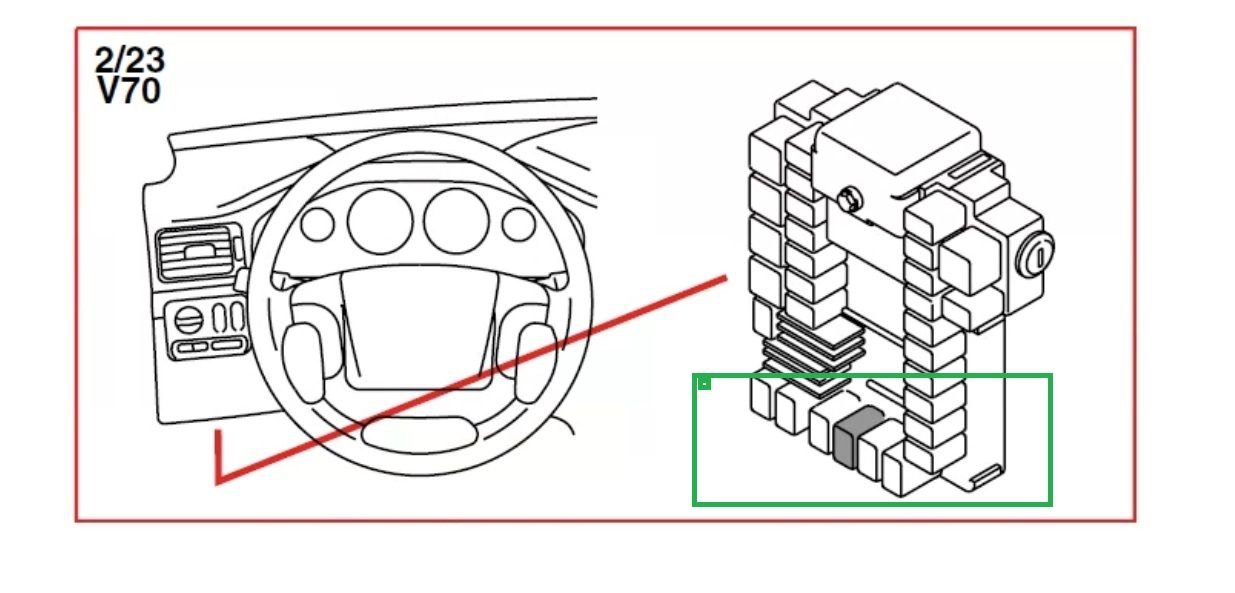

Dealing with a no fuel delivery situation on a car not started in a while. Not getting pressure at the rail ( poked the schrader, got nothing) fuse is good. Could bad gas have caused the relay to shut down?
Old Aug 17, 2023 | 09:13 PM
Here's where the fuel relay is your 2003 turbo car.
Old Aug 17, 2023 | 09:47 PM
joseph capra's Avatar
Joined: Sep 2016
Posts: 30
Thanks! Now I'd like to know if there is an identical relay on that board to swap with like a fog light or something to swap to see if I need to replace the pump relay.
Any ideas? From this diagram, I dont know what the adjacent relays do
Old Aug 18, 2023 | 07:59 AM
Find one the same part number one the CEM and swap it. Remembering where it came from and went to
