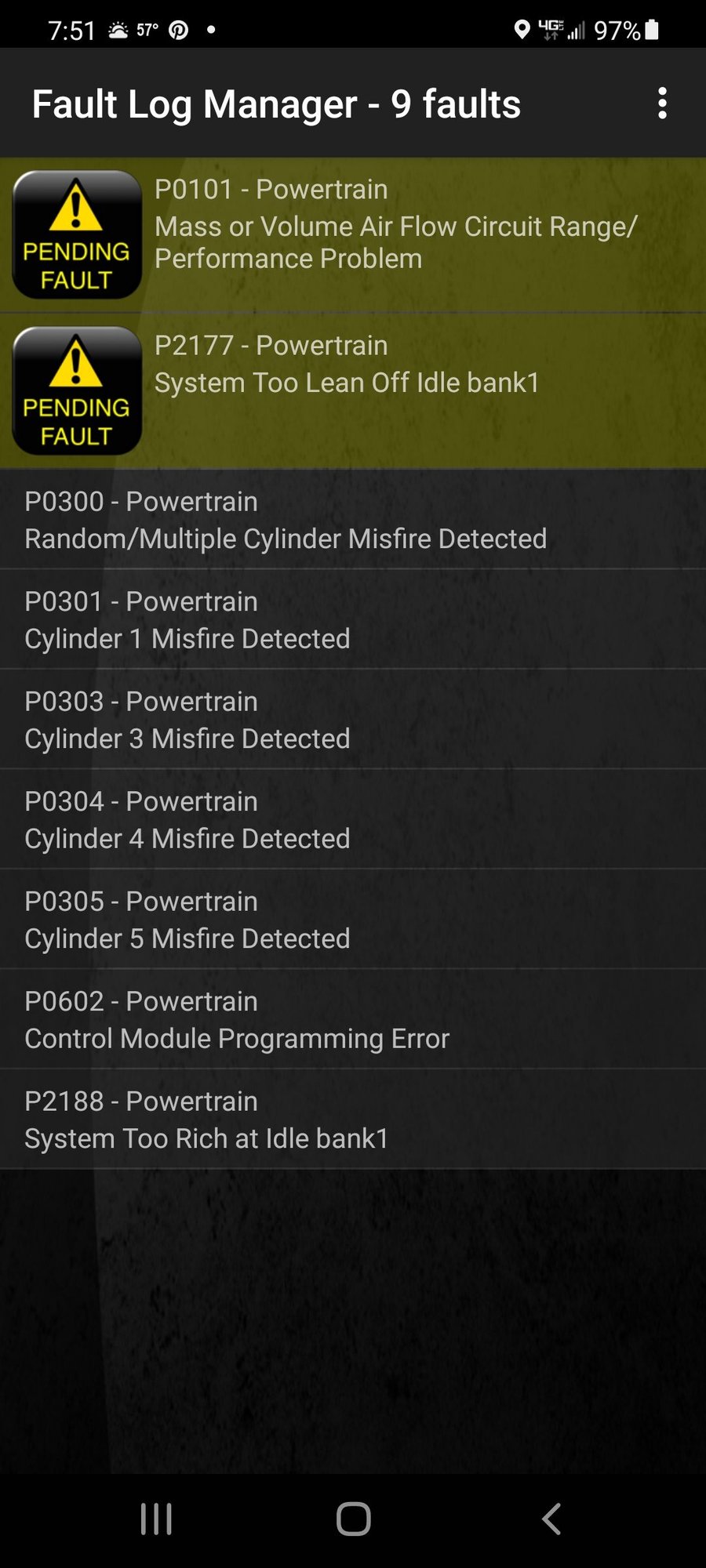

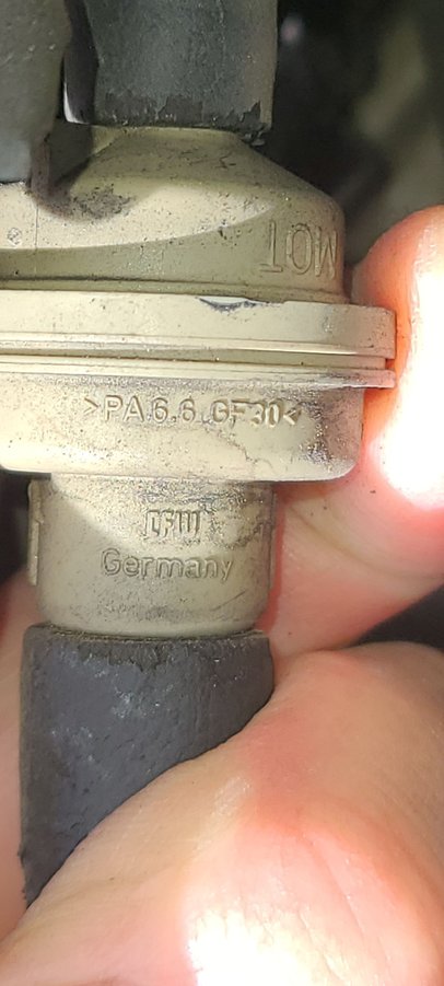

I cleared all the codes and the MAF code keeps returning. I found a collapsed tube on the evaporative emission control system so I am thinking that one of these little gray canisters my be blocked. Could this be throwing the MAF code?

Turn the AC off it goes away. Turn it back on it runs rough and lopes. Showing misfire on 3 &5. Newish spark plugs and coils. Runs great at driving speed and hard Acceleration is great.
