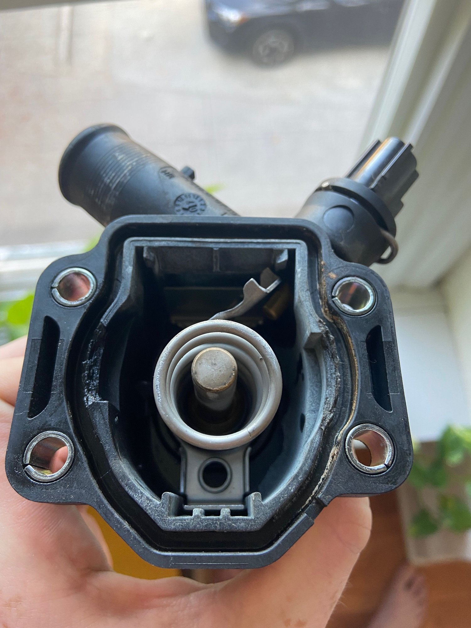

Yup as you suggested it was the plastic tabs on the thermostat. Quite a poor design.
Thanks for your help.
