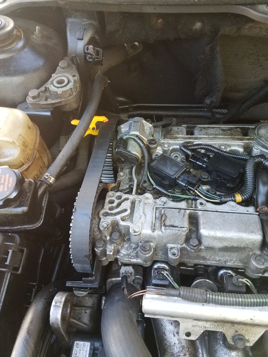

I went to a different supplier and was sold a smaller cam seal than first two times. The difference is like six mm. The smaller seal indicates without vvt. All the others tat iI was sold indicate w/vvt. The cam in need is the front intake, it does not have the extra sensor on the front although it is tapped on the block for the sensor bolts that hold on the rear exhaust cam sensor (See attached picture).
Have the mechanics been adding the incorrect seal to the front 6 mm is a huge gap.Engine is B244T3 ending vin49992

From: Kingsport, TN
Well, in your own photo, it's evident that the rear cam has VVT and the front cam doesn't, because you can see the actuator there and where one isn't mounted also.
